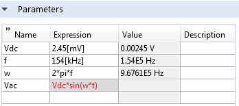

I want to apply AC Voltage source. I have tried to define the parameters. Where I am making the mistake?

You must add the time t to the list of parameters, initialize with 0[s] for instance. The value will
be replaced in a transient simulation.
