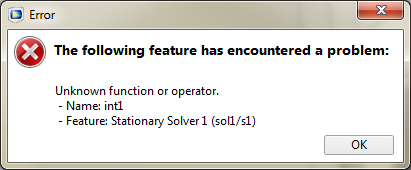

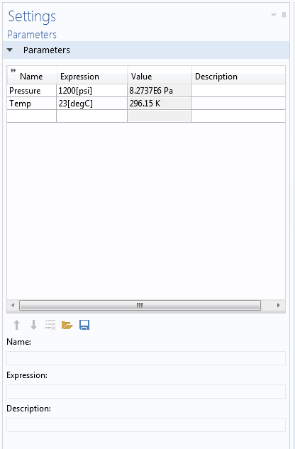

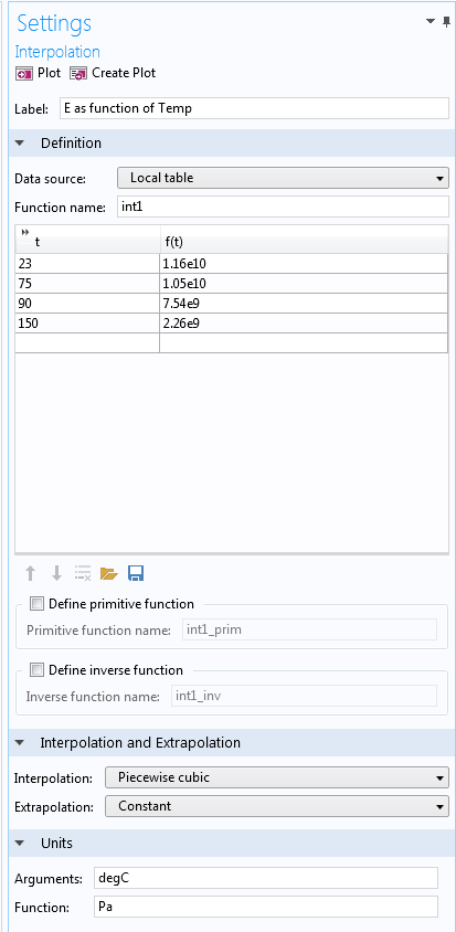

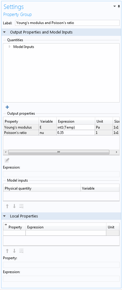

Within a 3D stationary structural mechanics model, I have created an interpolation function to define the Young's Modulus as a function of Temperature at a few discrete temperature points. I have defined the interpolation function as shown in the attached image. I have then set the Young's Modulus within the material property to equal int1(Temp), where Temp is a global parameter I have created, again, shown in the attached image.
When I try to run the model, I get the error message:
"Unknown function or operator.
Feature: Stationary Solver 1 (sol1/s1)"
Any thoughts?

See if the suggestions here help:
www.comsol.com/community/forums/general/thread/116362/#p258731
If not, please consider posting your mph file - you can make it smaller by clearing the mesh and solutions if need be.
See if the suggestions here help: https://www.comsol.com/community/forums/general/thread/116362/#p258731 If not, please consider posting your mph file - you can make it smaller by clearing the mesh and solutions if need be. Jeff
Posted: 9 years ago 21 giu 2016, 12:00 GMT-4

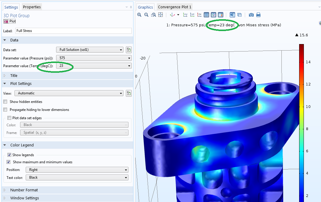

Fantastic, that was exactly what was needed. I had assumed that as there was only 1 component and 1 interpolation function in the model, it would be OK, but explicitly defining the function worked a treat. I have come across a (possible) bug though.
My model has 2 parameters that I sweep through, Temp[degC] and Pressure[psi]. The Titles in the chosen result seem to indicate incorrect units for the Temp parameter, as highlighted on the attached image. I have removed solutions/meshes and attached the model for your perusal.

That caption does look funny, indeed. I invite you to bring it to the attention of our support team: this is how we track incoming reports of possible bugs.

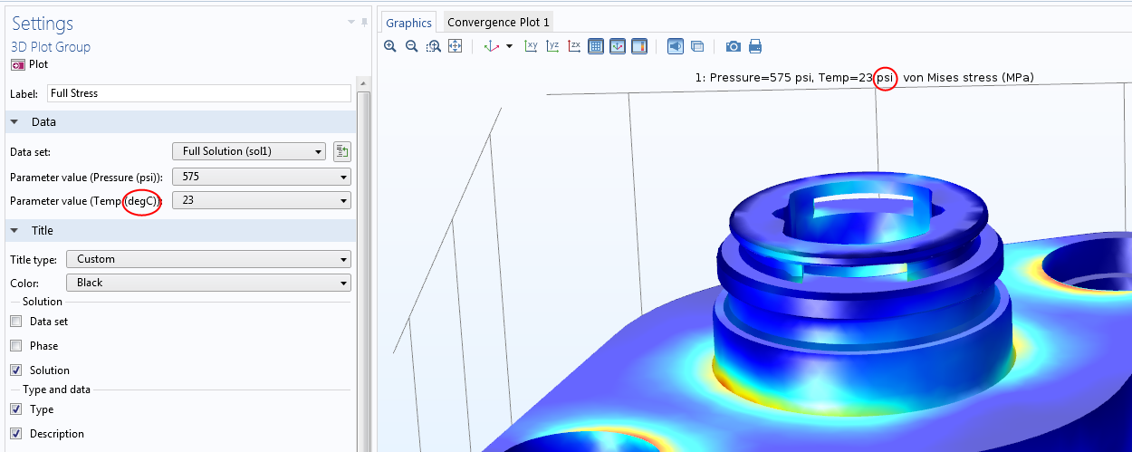

Update: I was able to reproduce your screenshot in 5.2, but not in 5.2a, see my attached screenshot. It looks like this bug was crushed by our latest release.
PS: Here is one more reason to upgrade from 5.2 to 5.2a: on my machine, your model solves about 6% faster with 5.2a than with 5.2.
