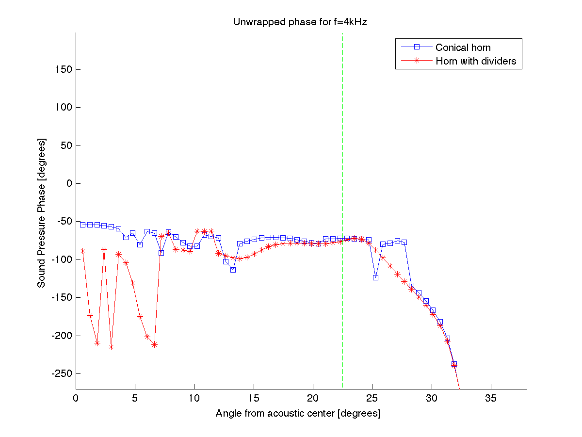

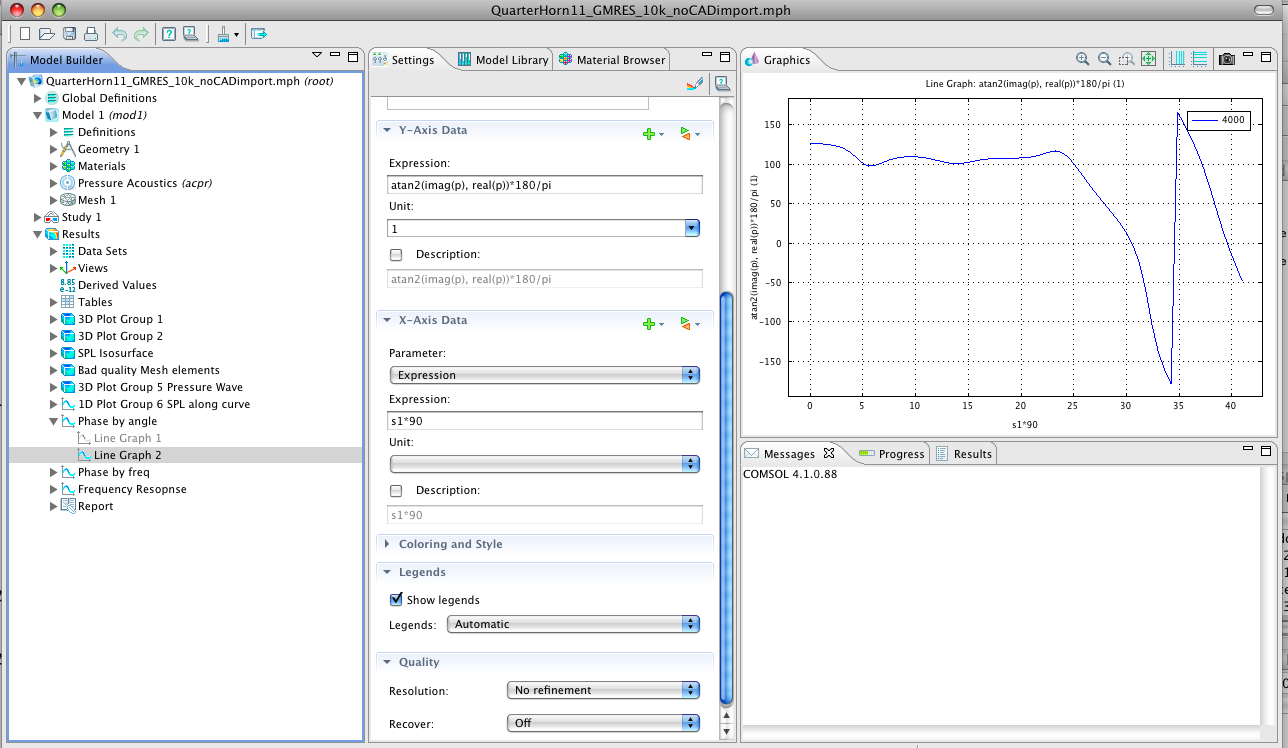

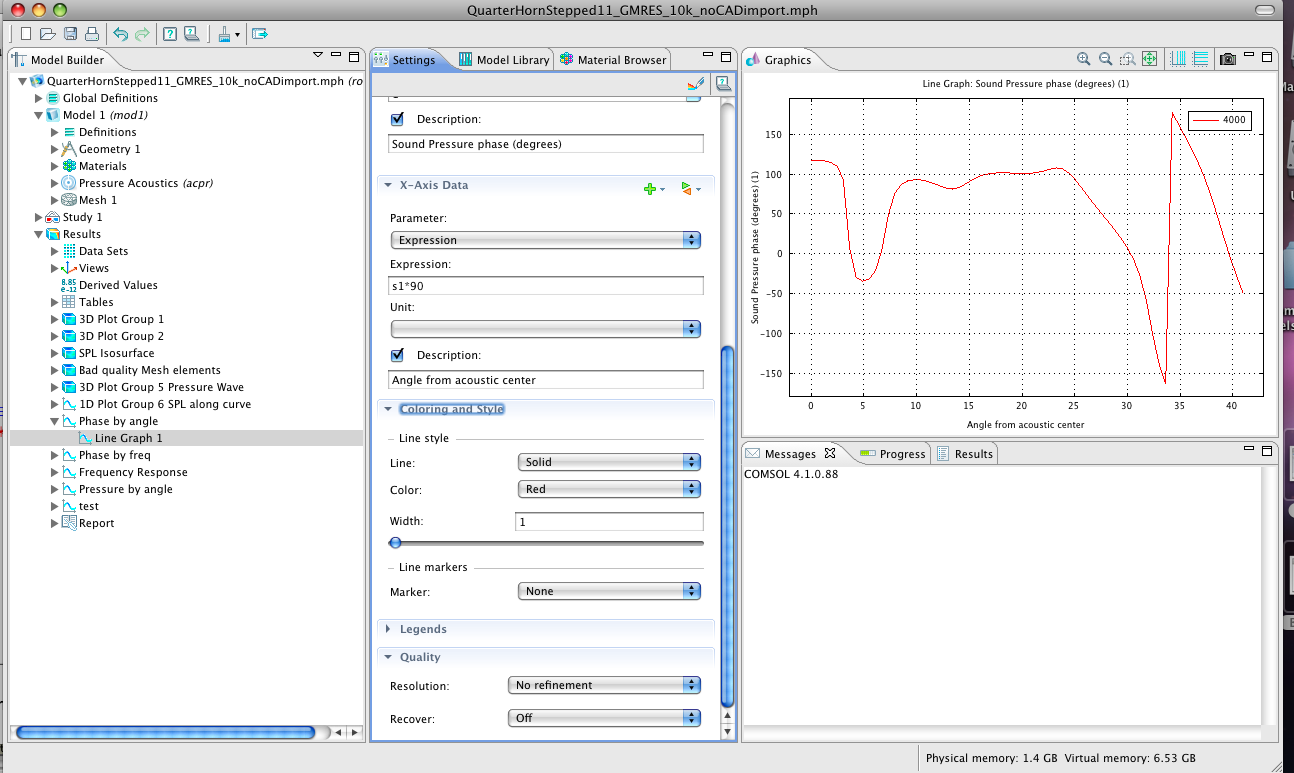

Without refinement, Comsol plots have a denser dataset and are much smoother than the plots in Matlab. I have to export the data to Matlab in order to unwrap the phase plots.
In addition to the smaller dataset, there are some strange deviations in the Matlab plots. This can be seen in the enclosed pictures. Ideally, these plots should be identical (except for the phase unwrapping).
