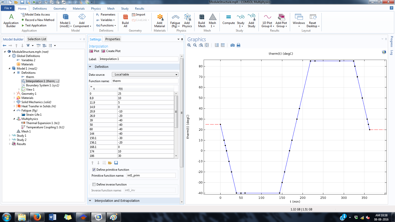

I have constructed the cycle by using interpolation, and called the function as 'therm' with units of argument in 'min' and function in 'deg-C'. Attaching the screenshot (interpolation.jpg) for reference.

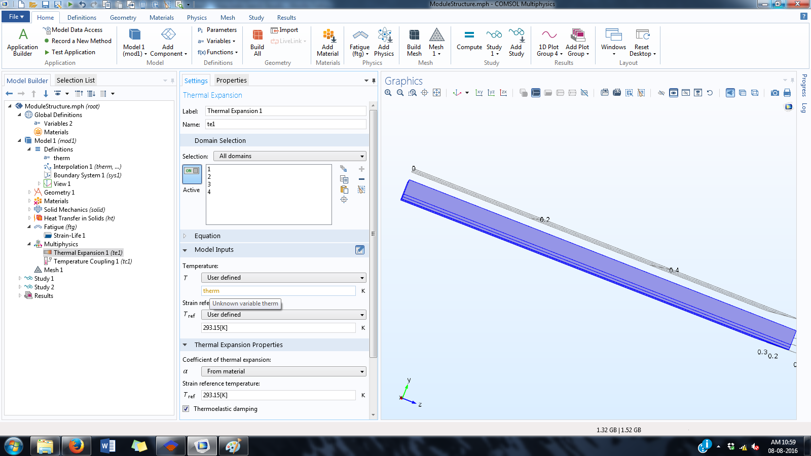

Now when I am calling this function as a 'model input' in the 'thermal expansion' study under the user defined temperature, it is showing 'therm' as unknown variable. Attaching the screenshot (unknown variable. png) for reference.
I have also tried inputting 'therm (t[min])' or 'therm(t), there it shows 'syntax error in expression'.

If the therm is for whole domain than you do not need to solve heat transfer node. In thermal expansion multiphysics coupling node directly type therm(t) in temperature input box.
