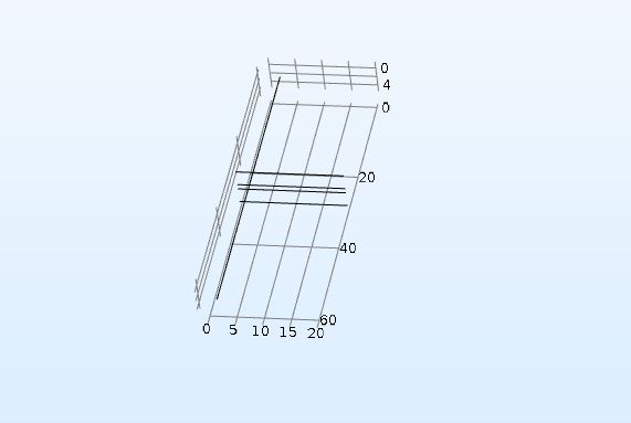

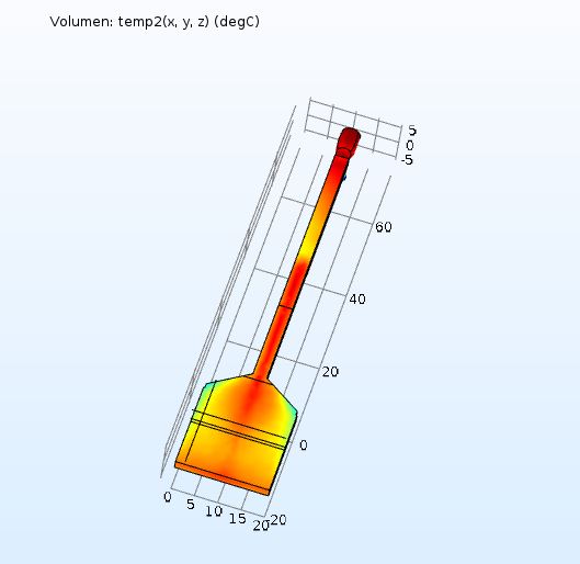

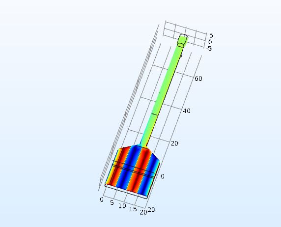

So far I generated two modells with different geometries. In my first modell (20x20x1_1.0s) I'm able to plot the solutions properly (temperatur plot/Plot flux density (BT entformt).

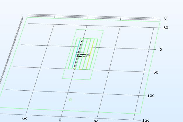

This modell I used a basis to generate my second modell with a slightly different geometry (20x60x1_1.5s). I used exactly the same settings but for some reasons I'm unable to plot/calculate the solutions (temperatur plot_new modell/Plot flux density (BT entformt)_new modell) like they showed up in the first modell. It seems that only the edges are displayed but not the whole part.
I can't find my mistake! It would be great if someone could help me....

You can not see all geometrical entities in you plots because several domains are hidden - take a look at Component/Definitions/View node.
Sergei
Maximilan, You can not see all geometrical entities in you plots because several domains are hidden - take a look at Component/Definitions/View node. Regards, Sergei
