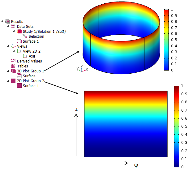

Posted: 9 years ago 19 set 2016, 11:34 GMT-4
Ben,
Steps to plot flat cylinder are shown in the attached png and mph files.
Sergei
Ben, Steps to plot flat cylinder are shown in the attached png and mph files. Regards, Sergei
