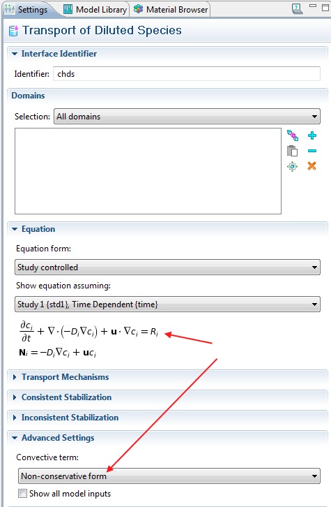

Posted: 1 decade ago 28 dic 2010, 10:02 GMT-5
As Danial pointed out, the default formulation for Transport of Diluted Species is non-conservative. But you can change it through the "Convective term" setting on the Advanced settings section. Switch on Show More Options in the view menu to enable the Advanced setting. See attached screenshot. If you have a fluid that is compressible, you should change it to conservative.
You mention a mass source in a porous medium (due to phase transition). That is another story, use the mass source term Q_br in the Brinkman Equations or Free and Porous media physics interface.
