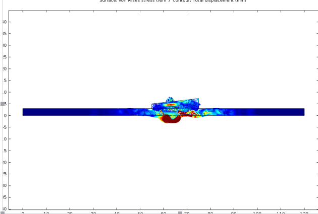

I want to simulate the wave propagating in plate, but the animation show the stress deformation is out of the border of material, as i show in attachment.
what's the reason?

Your question is not very clear (and your image does not include the legend so that I can see what you are plotting).
You are apparently plotting the deformation. You can turn off the deformation plot (and just use color to show deformation or stress). Alternatively you can adjust the scale factor used for the deformation plot.

Thank you, I get the ponit, I will be down,
