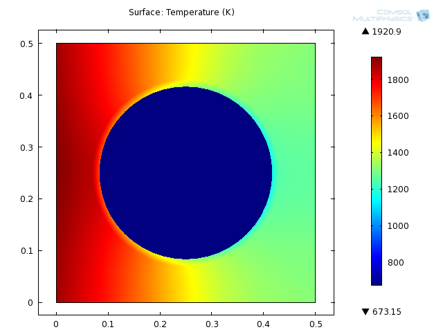

I am trying to simulate a fluid flow in a pipe and this pipe inside cubic box and this box is subjected to heat flux at upper half. I have turbulent flow. The heat transfer from the solid cubic box to the solid pipe to the fluid. I have two basic questions.
What is the different between Conjugate heat transfer and?non-isothermal fluid flow ??I believe that the conjugate heat transfer should selected when the heat transfer from solid to fluid. Please correct me if I am wrong
The second question I tried both of conjugate and non-isothermal fluid but the fluid temperature at the exit is around 450 c (inlet temperature is 400 c) although the pipe surface temperature is around 1600C. It should be more than that

The same results I got please note that temperature unit in keliven , so the inlet tempearute is 673K and the output in the range of 673K to 800K. I think something wrong
By the way how I can calculate the output temperature with comsol . I tried to intergatea the area but the reuslt was wrong
HI The same results I got please note that temperature unit in keliven , so the inlet tempearute is 673K and the output in the range of 673K to 800K. I think something wrong By the way how I can calculate the output temperature with comsol . I tried to intergatea the area but the reuslt was wrong

Fluid temperature at the exit is slightly change which l is annoying me . I am feeling there is a problem when the heat transfer from the solid domain to the fluid domain
Hi I am sorry to ask this question agian but I really need some help Fluid temperature at the exit is slightly change which l is annoying me . I am feeling there is a problem when the heat transfer from the solid domain to the fluid domain

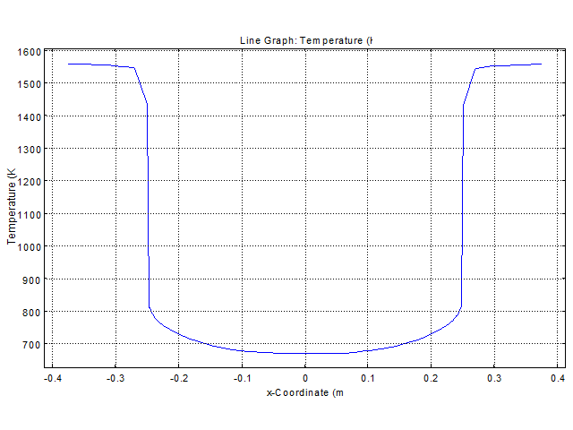

I do not have enough free time to reply just now, but clearly from the profile that I got by using a cut line on the outlet you have a steep gradient, so your fluid has a low heat conduction, or a high speed ;)
to calculate the average temperature you use the average operator on the outlet surface, but I beleive the T proile is more interesting. You add a Data set by right clicking on the data set node
Hi I do not have enough free time to reply just now, but clearly from the profile that I got by using a cut line on the outlet you have a steep gradient, so your fluid has a low heat conduction, or a high speed ;) to calculate the average temperature you use the average operator on the outlet surface, but I beleive the T proile is more interesting. You add a Data set by right clicking on the data set node -- Good luck Ivar

Here is a suggestion. Use engineering correlations to calculate expected heat transfer coefficient based on Re & Pr numbers and then solve a simple problem that is similar enough to your situation (e.g. with constant wall temperature of 1600 C ) analytically. You might be surprised to find out that your liquid temperature increase really is small. Be careful to make the distinction between local and mass flow averaged fluid temperatures.
hope this helps
Ozgur
Here is a suggestion. Use engineering correlations to calculate expected heat transfer coefficient based on Re & Pr numbers and then solve a simple problem that is similar enough to your situation (e.g. with constant wall temperature of 1600 C ) analytically. You might be surprised to find out that your liquid temperature increase really is small. Be careful to make the distinction between local and mass flow averaged fluid temperatures. hope this helps Ozgur
