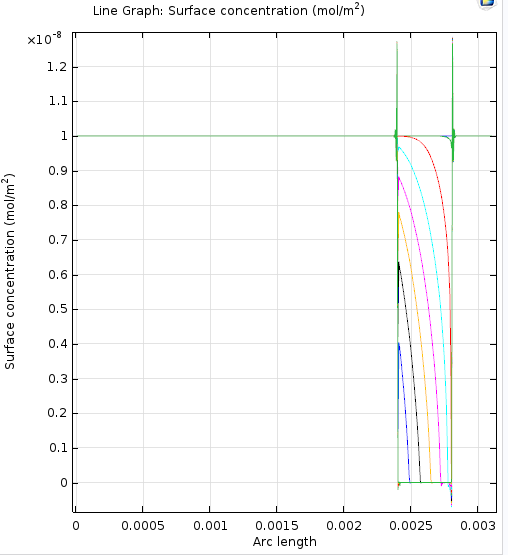

i am modeling a laminar flow through a small channel with a surface reaction taking place on a small surface of one of the walls. This wall has an initial reactant B on it, which should be converted to product C through a reaction with reactant A introduced through the laminar flow.
The problem with this model is that the concentration of B on the surface can reach negative concentration. (which is equal to the concentration of C on the surface going over the initial concentration of B). even though i have set a number of maximum available sites on the surface, which is the same number as initial reactant B on this surface.

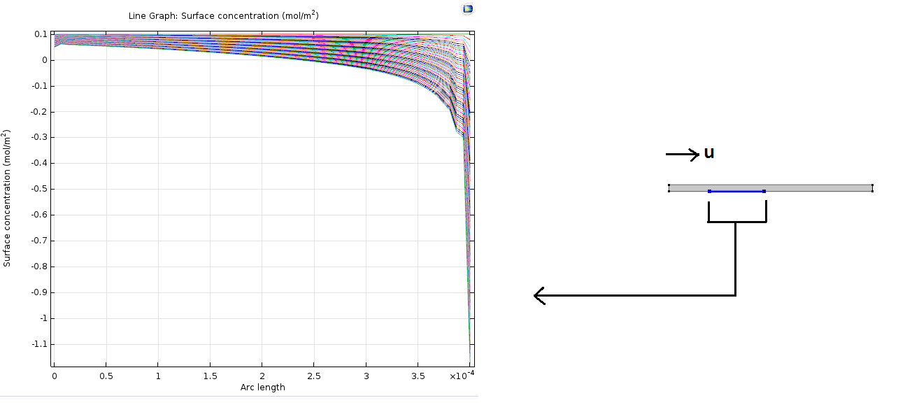

No,it starts at the edge of the reaction surface, but as time increases a greater portion of the surface reaches a negative concentration. I've included a picture of the domain i'm talking about.
i've tried refining the mesh from extra course to finer, and decreasing the initial step size of the solver to 1e-10 but it gave the same results.

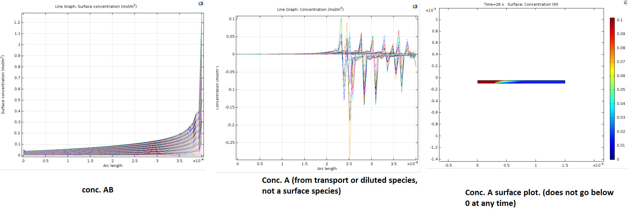

Can you also plot the concentration of A on the surface as well?
here are the plots of concentration AB on the surface. and Concentration A along the surface. (although last one is taken from the transport of diluted species data because A is not a surface species.) i also included the contour plot of the concentration of A inside the domain, which i never see falling below 0.
Sorry man, I am stumped. With your B concentration going negative, you should have a negative reaction rate, which should cause the generation of species A instead of consumption. But your A contour plot looks perfectly normal.

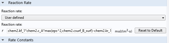

Just put "max(eps^2, R)" where you would put the user defined reaction rate. With R being your actual reaction rate. This should fix the issue.
Posted: 7 years ago 27 lug 2017, 17:53 GMT-4
Updated: 7 years ago 27 lug 2017, 17:55 GMT-4
thanks! i've put the term around my reaction rate term of the species which went negative in concentration. It seems to have fixed the issue!
[QUOTE] Just put "max(eps^2, R)" where you would put the user defined reaction rate. With R being your actual reaction rate. This should fix the issue. [/QUOTE] thanks! i've put the term around my reaction rate term of the species which went negative in concentration. It seems to have fixed the issue!
