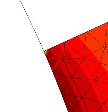

I'm struggeling with the same problem for quite a while. The thing I want to do is:
1) Solve a time dependet heat transfer problem with two simple domains (initiated with a different temperature) for e.g. t_start = 0 to t_end = 1 second.
2) Use the solution of step 1 and solve again for t_start = 1 to t_end = 2 second but now with a third domain added.
The new (third) domain has T_initial = 20[degC] and the two other domains should have the same temperature as at the end of step 1, so T = 'T' .
The problem is that on 1 vertex a really low temperature appears without any reason (way lower than any initial temperature in the simulation (see attached figure)). Does someone has any clou how this happens?

Since I add a new domain to the geometry, COMSOL automatically re-meshes the geometry. During the re-mesh (I guess) COMSOL has to interpolate in order to fit the solution as new initial value on the new mesh. During the interpolation something strange happens... because when I try the same without modifying the geometry (so no re-mesh is needed) the effect does not appear.
Could this be the source of the problem and do you perhaps know a way to solve it?
