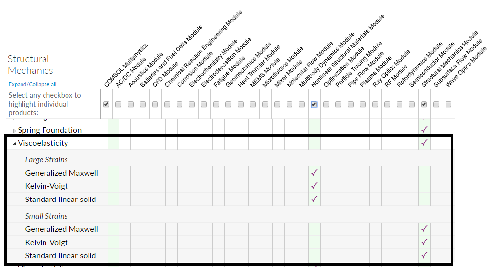

I am trying to model a volcano with viscoelastic material. But I cannot find the linear viscoelastic material mode option in my interface (solid mechanics(solid)>material mode>). I am using COMSOL 5.0. Can you help me with it.

Hello Bhuvan,
Viscoelastic materials are available only if your license includes the Structural Mechanics Module. They are not available among the structural mechanics capabilities of the core COMSOL Multiphysics. More options are available if your license includes both the Structural Mechanics Module and the Nonlinear Structural Materials Module. See the attached exerpt from the online product specification chart (www.comsol.com/products/specifications/),
To determine whether your license includes either of those products, go to File > Used and Licensed Products.
Hello Bhuvan, Viscoelastic materials are available only if your license includes the Structural Mechanics Module. They are not available among the structural mechanics capabilities of the core COMSOL Multiphysics. More options are available if your license includes both the Structural Mechanics Module and the Nonlinear Structural Materials Module. See the attached exerpt from the online product specification chart (https://www.comsol.com/products/specifications/), To determine whether your license includes either of those products, go to File > Used and Licensed Products. Best, Jeff

Dear Aseem,
I am also trying to use viscoelastic materials in COMSOL. But I only found the one material type named "linear viscoelastic materials" under the "solid mechanics" category (COMSOL 5.2). I wonder could you please tell me where is the viscoelastic material type whose inputs are Prony parameters Gi and Ti? Many thanks.
