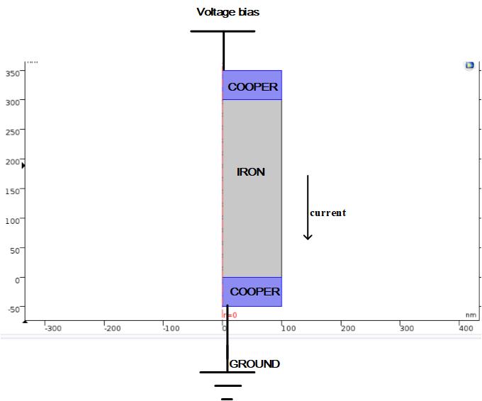

I built a cylinder conductor (axial symmetry), bottom surface is grounded, top surface is connected to a voltage source, i want to calculate the total current passing through the conductor in Matlab.

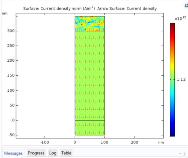

P.S the simulation works well in COMSOL, and the current density is reasonable, but it goes wrong in livelink with matlab when using "I = mphint2(model, 'ec.normJ','surface','selection',6)"
