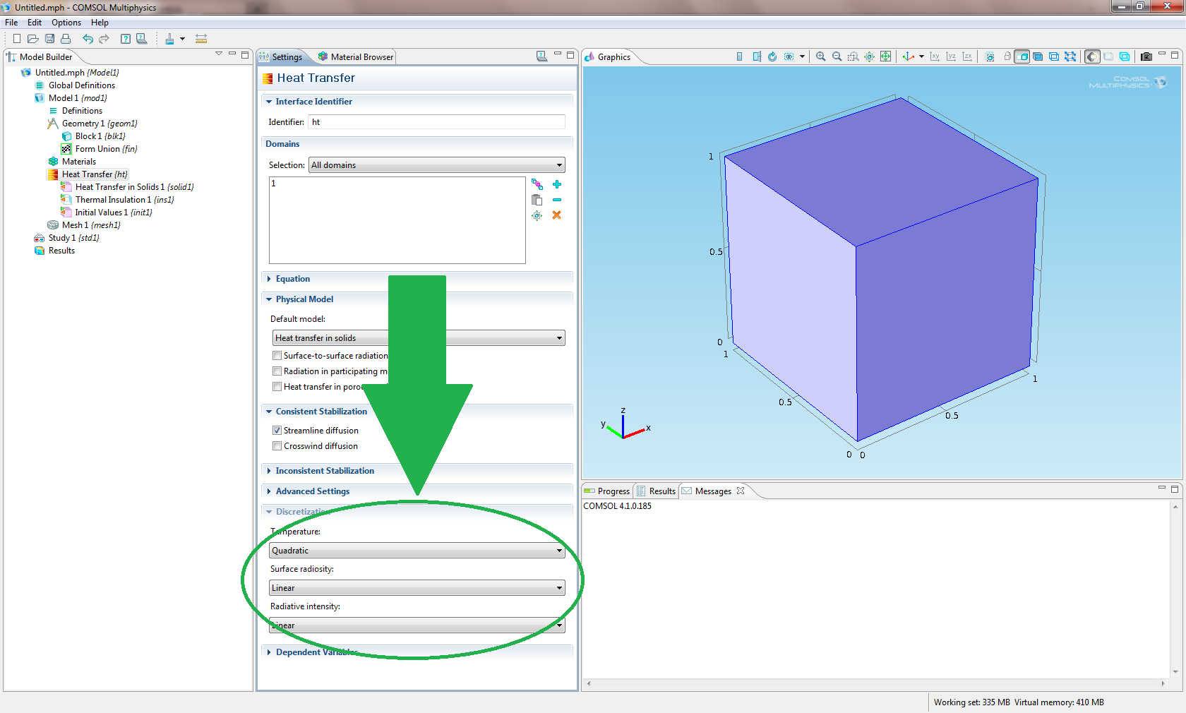

How can I change the interpolation type of my element in Version 4.1 of COMSOL.
I would like to switch between linear, quatratic and cubic interpolation schemes in the elements but have not found the switch yet.
