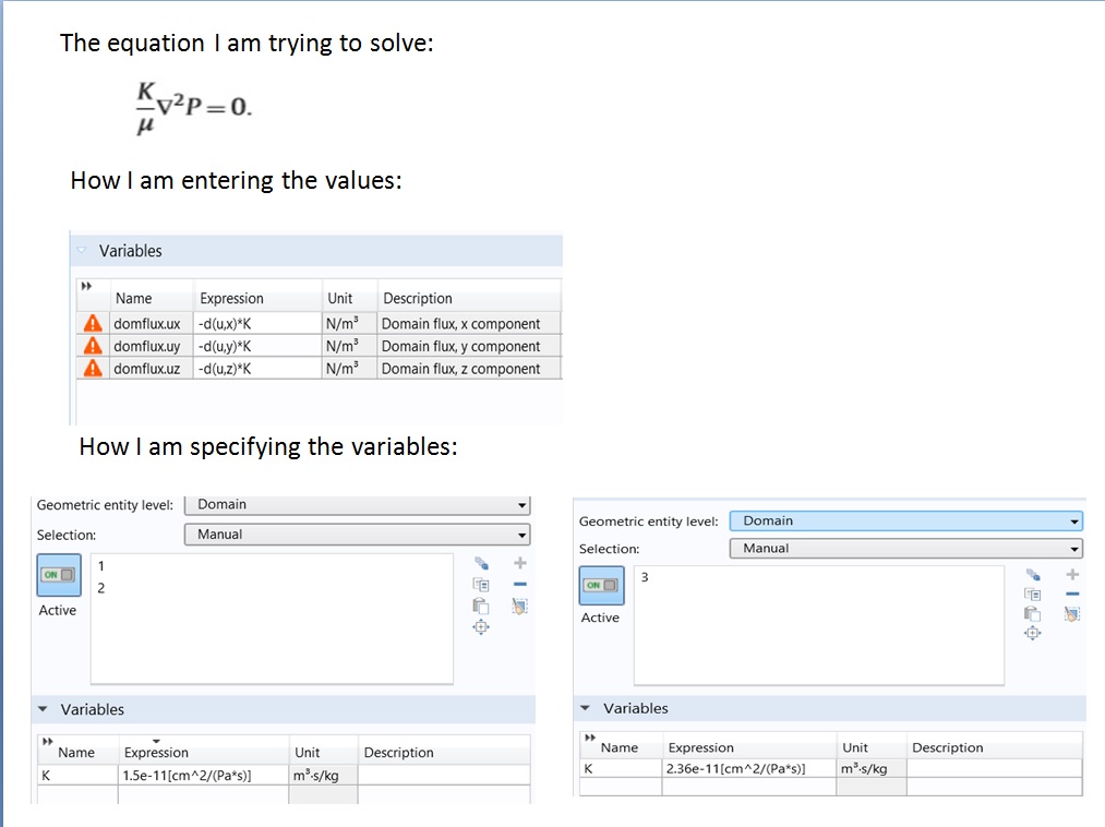

I just tried that and it doesnt seem to bring any change to the result. The left column in equation view has a warning sign inside it now. I have attached an image showing how I modified the Laplace equation. Thank you for your help

It seems that you are using the Laplace Equation interface, which really just solves . To get K into the equation, I would use the Coefficient Form PDE interface with c = K and all other coefficients set to 0. The warning sign indicates that you are changing the built-in definitions of those variables, which you can do, but you should then be aware that you affect the results. If you plot them, you can see that the K values set up as suggested in the previous reply do have an effect, but they will not affect the solution to the Laplace equation.

Hi Magnus that worked wonderfully. Thanks!
