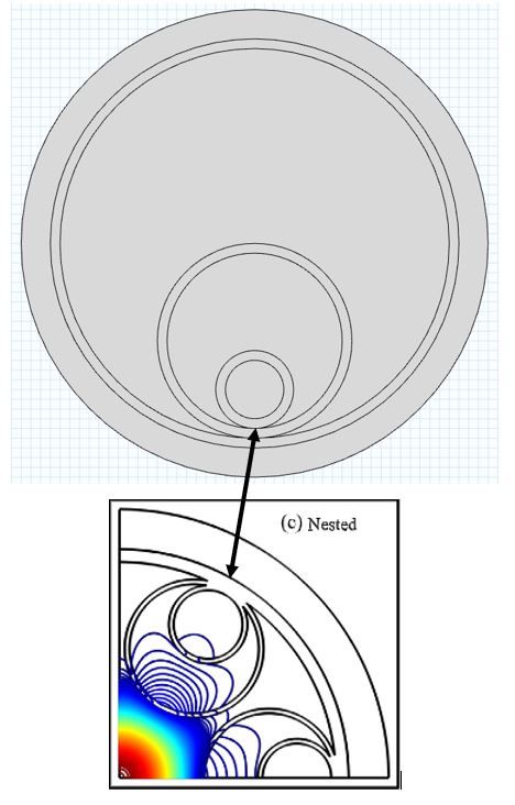

Hi, I am having some problems deleting the intersection points of two circle. Small circle is inside the large circle. However, they have intersection points. I wanna keep two circles but don't want the intersection points. I have attached two images. I want the second image from the first one. I would really appreciate if anyone help me to figure out.

If your circles only touch at a point then I can't see how you'll end up with the lower image. If the overlap is larger than a point then it is possible to get what you want.
There are probably many ways to get what you want. I've attached my attempt.

Hi Lars, The files you sent show that the the COMSOL model file is damaged or not valid. I am using COMSOl 5.3a version. Coudl you please help me with that. Note: the overlap is larger than a point.
