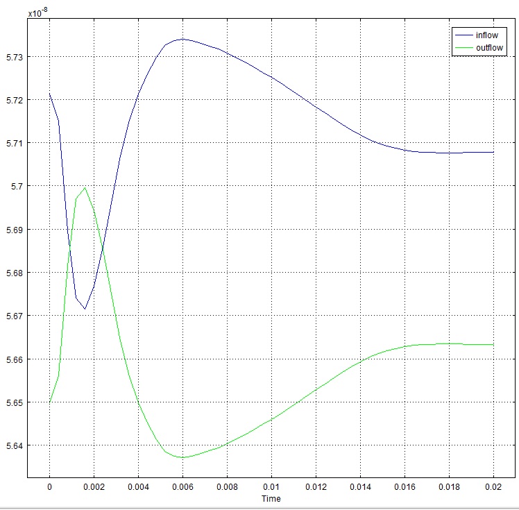

I have been doing a pump simulation but the results are incorrect. From literature, a valve less micropump should have sin wave inflow and outflow if a sin input is applied. However, my simulation result seems weird. Inflow is almost a mirror of the outflow (pls see attachment).
I am not sure what happened but at least all BCs are set up properly. Initial conditions are U0=0 and P=0. There are no errors or warnings popping up during the simulation.

The problem has been solved by myself.
What happened before was the error estimation and iteration.
I significantly increased both parameters and the results is reasonable.
