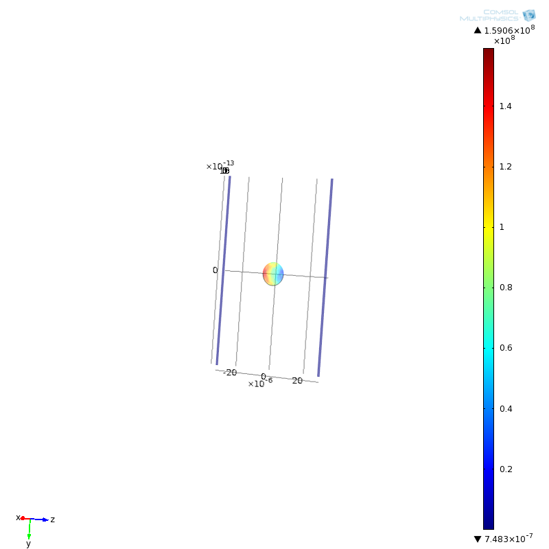

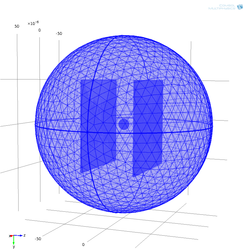

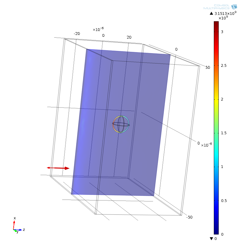

I am studying the effect of electric fields on cells, so I made ​​a simple model of this. The cell was modeled with a sphere with certain thickness, which represents the cell membrane and two electrodes where the electric field is applied. All this is covered by another spheroid that emulates the blood or extracellular fluid.
However, I have a problem when trying to make a cut plane (right click on data set->cut plane). I was able to plot the cell and the electrodes but not the extracellular fluid. Has anyone had a similar problem? Anybody know how can I solve this problem? Thank you in advance for any help,
Michael.
PD: I attach three picture. One with all domain, other with only he the cut plane and the last one with the solution on the cut plane.

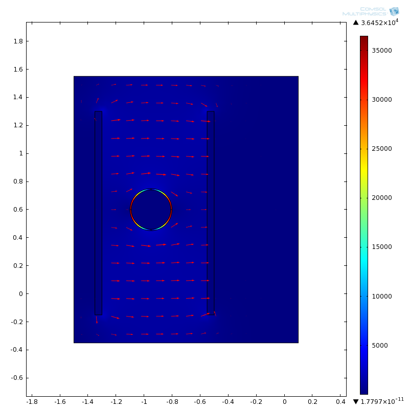

Hi John,
Thanks for your quick response; your comment has helped me to represent the part I needed.
However, the result is not that I expected, the electric field asymmetrical (attached figure) , when it should be symmetrical about the center. In addition, the electric current arrows are out of the slice, have you had the same problem?. There is someone who has previously resolved?
Thanks in advance,
Michael.
PD: I attached two images, one with the slice and other with the expected slice.
Hi John, Thanks for your quick response; your comment has helped me to represent the part I needed. However, the result is not that I expected, the electric field asymmetrical (attached figure) , when it should be symmetrical about the center. In addition, the electric current arrows are out of the slice, have you had the same problem?. There is someone who has previously resolved? Thanks in advance, Best regards, Michael. PD: I attached two images, one with the slice and other with the expected slice.
