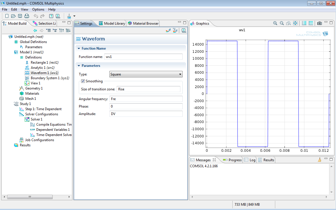

to generate symmetric pulses you can use the "wave square function" for your asymmetrical ones you need to combine a "pulse" to have smooth turn on and off, and a modulo to get it repeat.

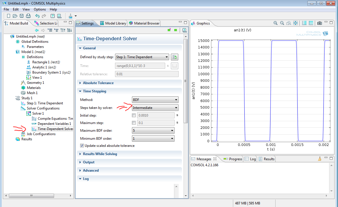

And do not forget to use "time Stepping" Intermediate, else your pulses will disappear

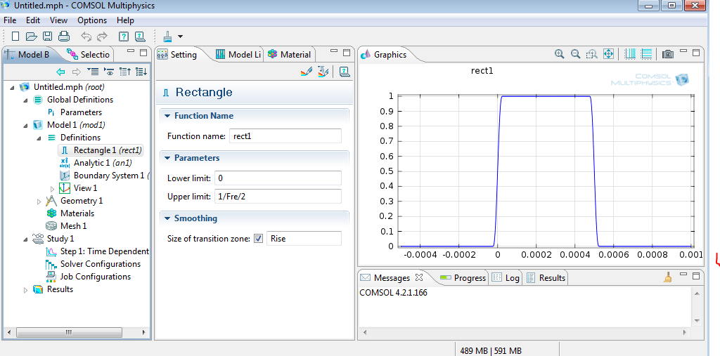

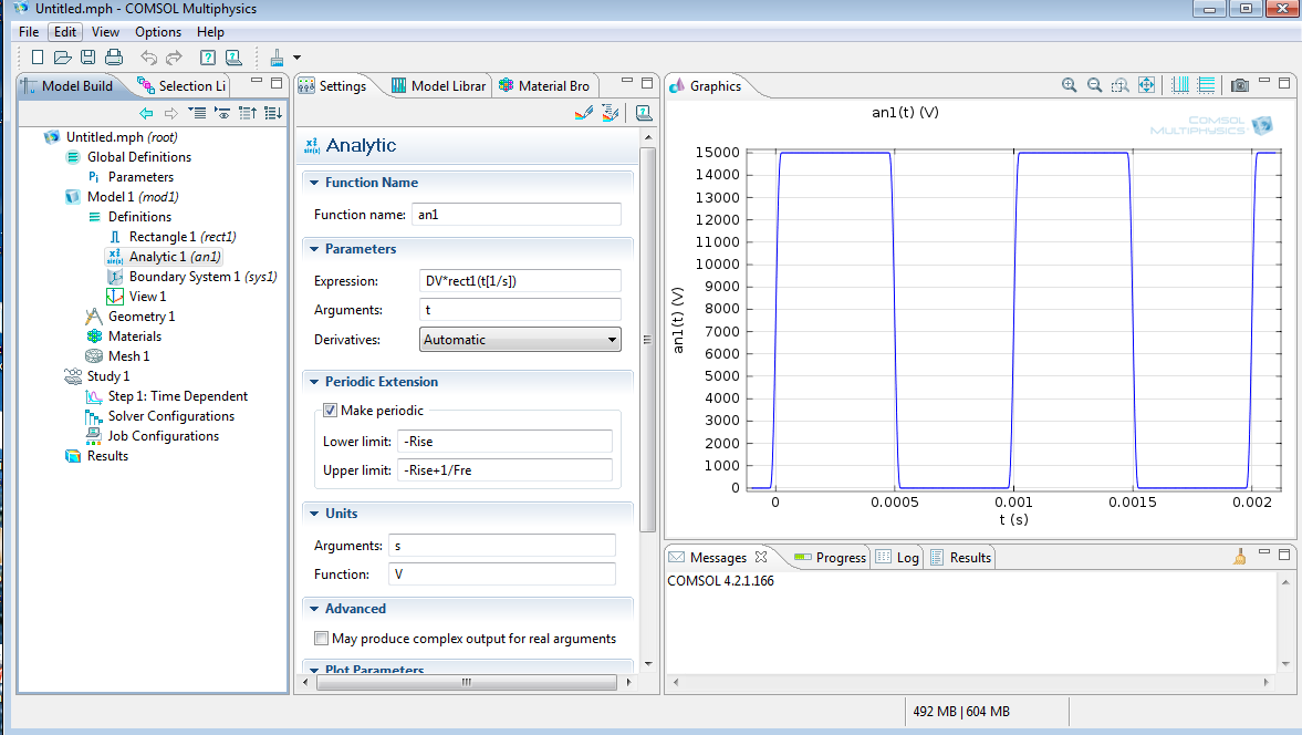

So that , the first problem to creat the pulse train for 4hours as follows:
i get rec1() ( lower limit= 0; upper limit= .5 E-3, transition= 20 E-6)
then , i add analytical function an1() from function
expression: 15000* rect1(mod(t,1E-3))
Argument : t
periodic fun.: make perid
lower limit : 0
upper limit: 3600*5
plot paremter;
Arg.: t
lower:0
upper: 3600*5
when i plot it , i don't receive my target
so what can i do?
--- another question (sorry for taking you time) what did you mean by time stepping in first reply? how can i use it in Comsol?

Here are some advises:
if you choose "make periodic", you do not need the "mod(t,1e3)", just "t" as the mod is already there
if you want to look at the plot, put Plot parameter 0 0.004 to see some details, if you ask for 12 million oscillation your screen resolution is not good enough. The plot Parameters is only for the visualisation of the plot of your function, nothing to do with the solver sequence.

Do not forget to define a time stepping for the time siler that sees the short rise and fall times

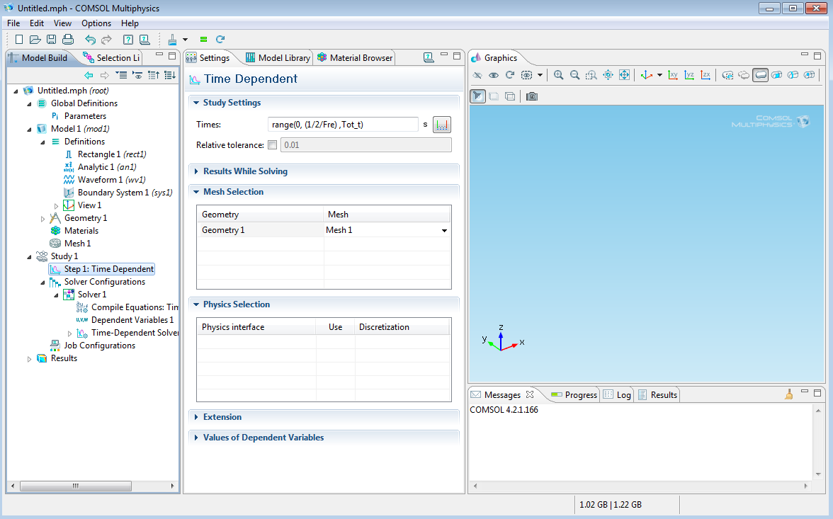

To get your solution to converge:
start using a "study 1 - Time dependent" range of range(0,0.0001,0.01)
And study 1 ... solver1 - Time dependent solver" tab, set the "Defined by study step" to Step 1 (and NOT User defined, else you must change the range 2x, this was a weakness in 4.0, no longer in the newer versions)

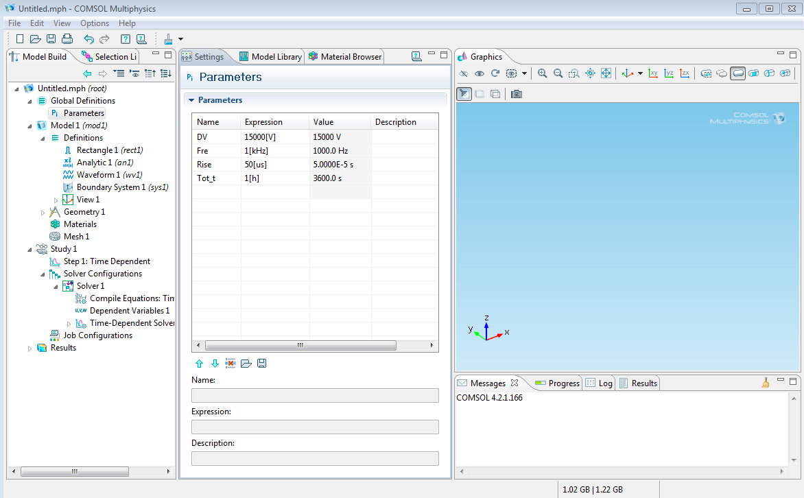

first in your meshing, delete the Free Triangular 1 (and leave the 2), (note: test later the mesh sensitivity, by setting the size to extremely fine, and then custom Resolution of narrow region = 3)
Then in your Global Definition rectangle type your Parameters to Lower Limit 0 + 0.1E-4/2 and Upper limit 0.5e-3+0.1e-4/2 and leave the smoothing to 0.1E-4
Like this your an1(t=0) starts at V=0 and not half way up 8000V, which is too much for the solver
Then it works better

I remain convinced that you should rather analyse 1 pulse, extract the average energy there from and apply that in a stationary analysis rather than trying to resolve 5 hours of 1kHz, 20us rise time rectangular pulses. But up to you to try. Anyhow COMSOL does not allow to have more than a few hundred thousand elements in a list so you must stop and restart manually each "1 hour"
You could try something like this (4.2a):
Thanks Ivar! Really helpful.
[QUOTE] Hi I remain convinced that you should rather analyse 1 pulse, extract the average energy there from and apply that in a stationary analysis rather than trying to resolve 5 hours of 1kHz, 20us rise time rectangular pulses. But up to you to try. Anyhow COMSOL does not allow to have more than a few hundred thousand elements in a list so you must stop and restart manually each "1 hour" You could try something like this (4.2a): -- Good luck Ivar [/QUOTE] Thanks Ivar! Really helpful.
