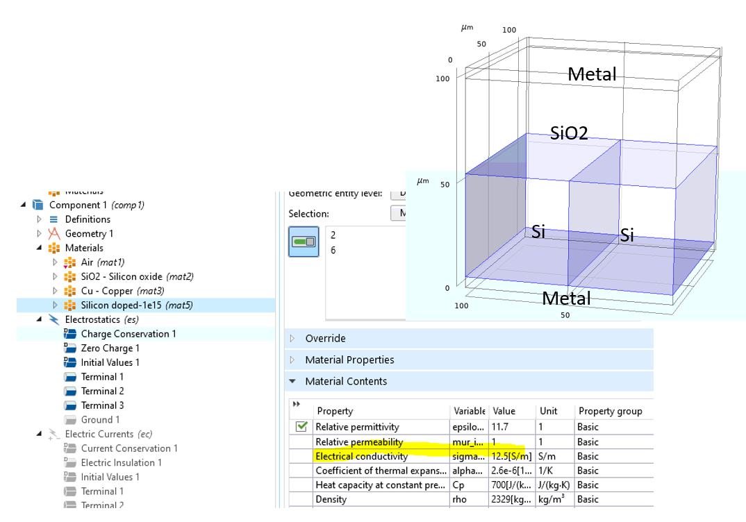

I am using comsol 5.5 electrostatics module. I use it to extract capacitance between different terminals.
I came across a problem where a Si (silicon) block domain needs to be defined in the electrostatics node between two terminals. The relative permitivity is used in this node. But it's also a doped silicon which has low resistance that acts as a conductor. However, electrostatics node is not accounting for this.
May I know how can I incorporate Silicon's electrical conductivity? Shall I couple another AD/CD sub module to do this?
Attached is an image, and the COMSOL file.
Thanks, Stacey

you must use electric currents (ec) then. Make sure that all domains also the insulators have a very small conductivity, otherwise the solver will not converge.
Cheers Edgar
