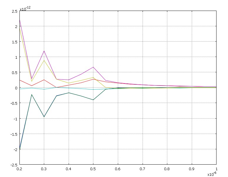

I only got started with COMSOL and was very happy to find the Model 'Mie Scattering off Plasmonic Nanoparticle and Radar Cross-Section Computations'. I followed all the instructions, but when I tried to do the mesh, it wouldn't let me do the swept mesh at first, saying there are involuted elements (even though I followed the instructions to the letter)...
I tried the swept mesh some more and suddenly, it was working fine - until, after 2 hours of calculation time, I saw the results: lots of warnings about an 'inverted mesh element near coordinate (9.24802e-008,9.24802e-008,2.6999e-007)' (these coordinates change slightly when I solve again) and a global variables plot which looks completely unlike the one in the documentation (see attached). What is going on here? I'm at my wit's end...
Thanks in advance for any help!

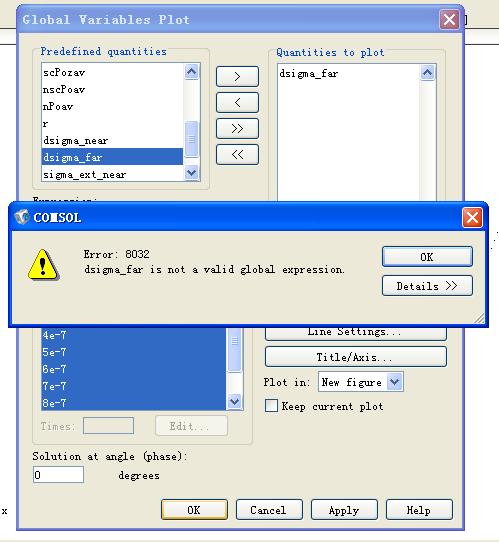

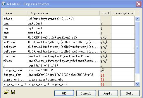

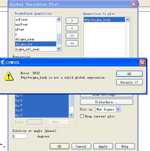

Hi, I am happy to find your example about radar cross section. But I met a problem when I fllowed your example. It happend in Global Expression(dsigma_near, dsigma_far). When I want to plot 4*pi*sigma_back, I met the problem as fllowed: disgma_far is not a valid global experssion. I do not know why.

I believe there is a quick reply for your units issue the "r/1[m]" this gives [m] if "r" is without units, or [m^2] as I expect "r" is in [m] and is different from "r/(1[m])" which is without units or equivalent to understanding it as (r[m])/(1[m])
Will have to look closer for the global expression, but I'm a t a Comsol course just now ;) and Ihave to liten to the speaker too ;)
Have a nice day

But even though I have changed this in my model I can't get it to work because I still get the error "unexpected unit of input" for the dsigma_far variable : (normEfar^2/(r/(1[m]))^2)/abs(E0)^2*r^2 where r is defined as sqrt(x^2+y^2+z^2)
In equation view under far field calculation tab I see that the normEfar is in V/m units and so is E0 so the expression should give me units of m^2 which is what I want.
Does anybody know how to fix this error?

Indeed naming has changed quite a lot between 3.5 and v4.
For the units, do not forget that orange unit flagging is only a warning, it will solve in any case, (but it might be wrong)
it could be that abs() is not passing the units, try it out in a post processing field
