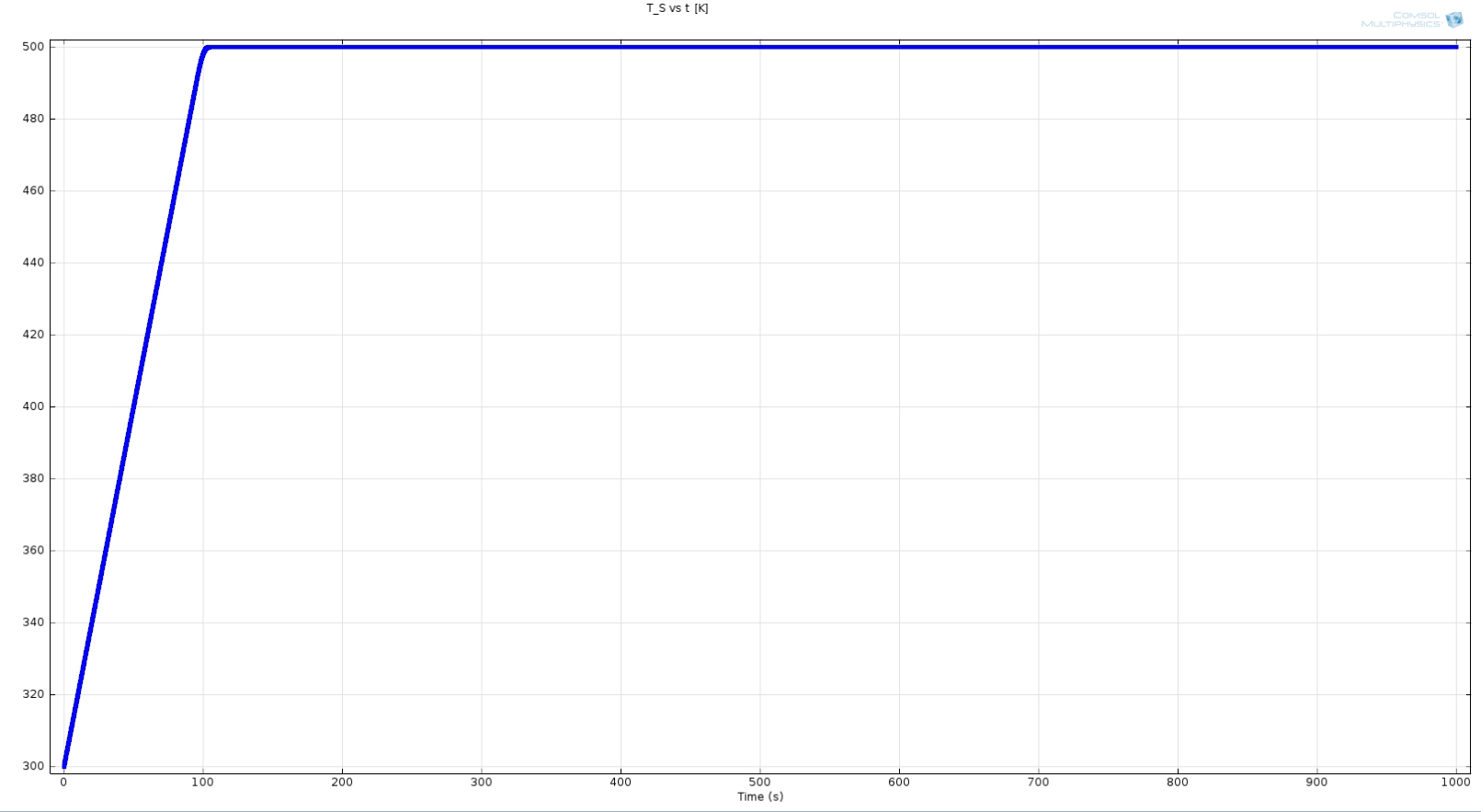

k Is defined as: k0 * exp( -E_A / R * T)

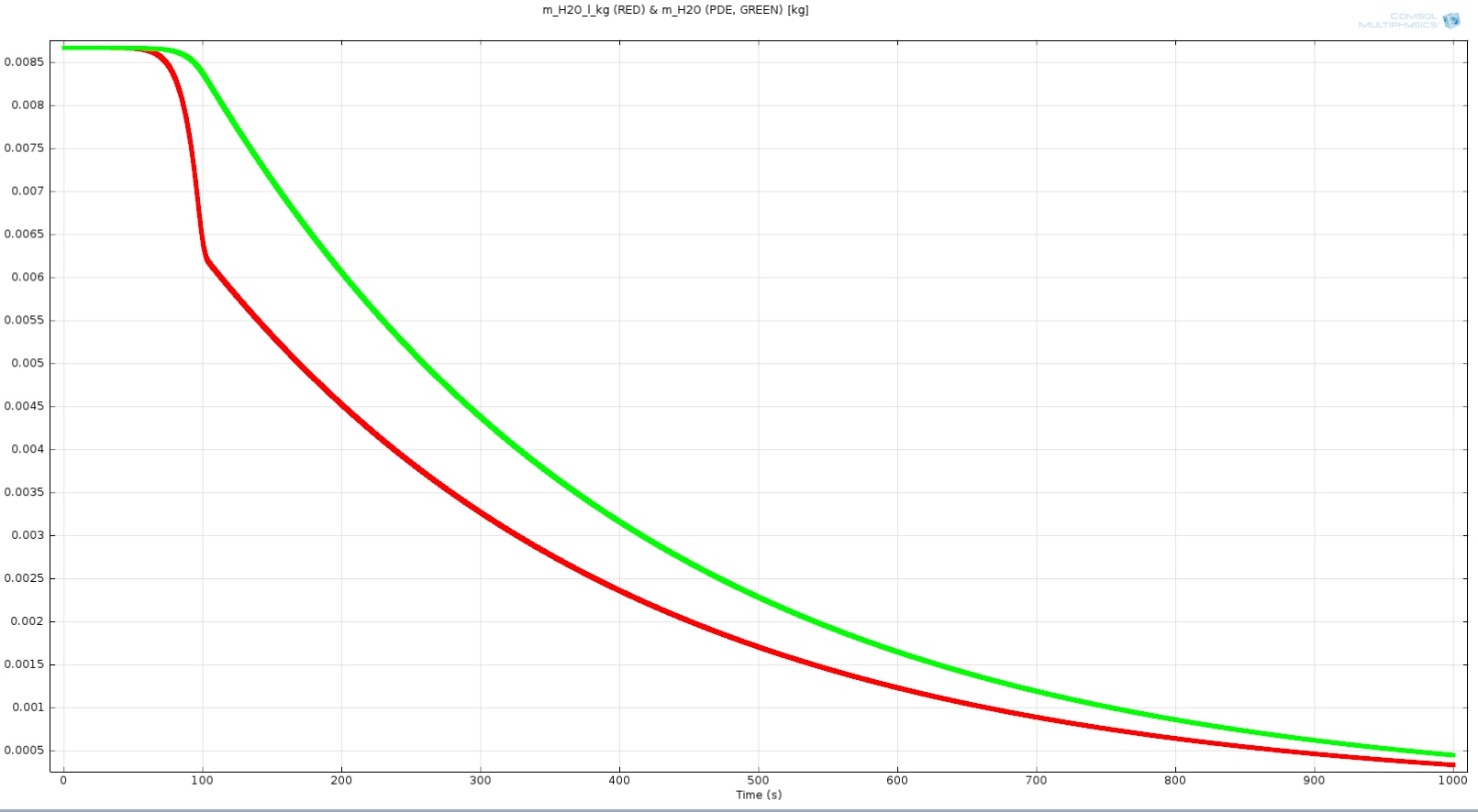

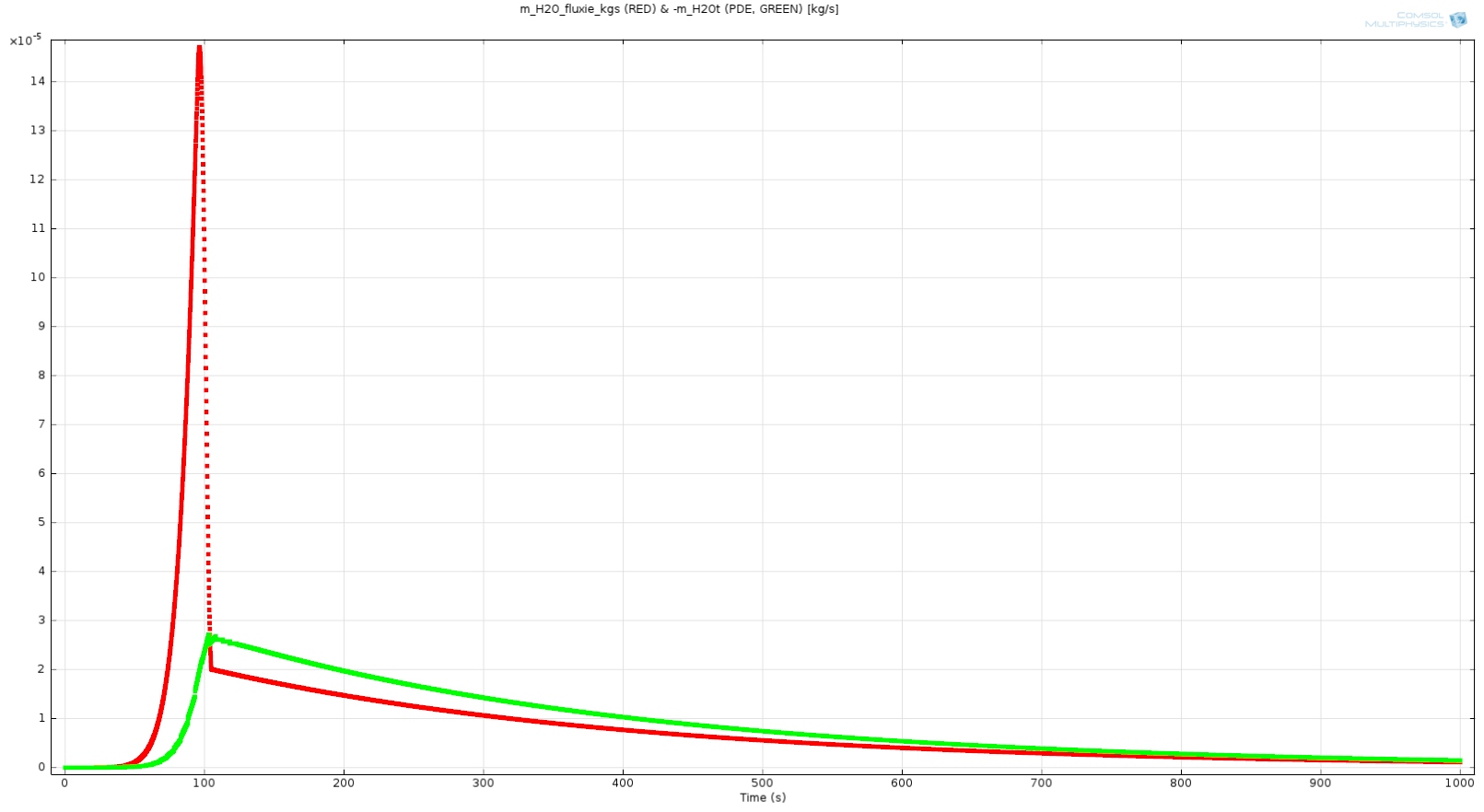

If I model this (as mass, using constant volume and constant molar mass), I get two different equations:
1] expression for mass left and mass flux, modeled as variables:
m_H2O_l_kg = Moisture_init_wtkg_zone*exp(-k_H2O*t)
m_H2O_fluxie_kgs = -d(m_H2O_l_kg,t)
2] function directly modeled using a PDE (general form)
dm_H2O/dt = -k_H2O*m_H2O,
initial mass = Moisture_init_wtkg_zone, initial flux = -k_H2O * Moisture_init_wtkg_zone
The problem is that I expect the results to be exactly the same, but they are quite different!
I included the plots and a very simple model using these functions.
Could anyone explain the difference? What am I missing here? (And which method is actually right?)
