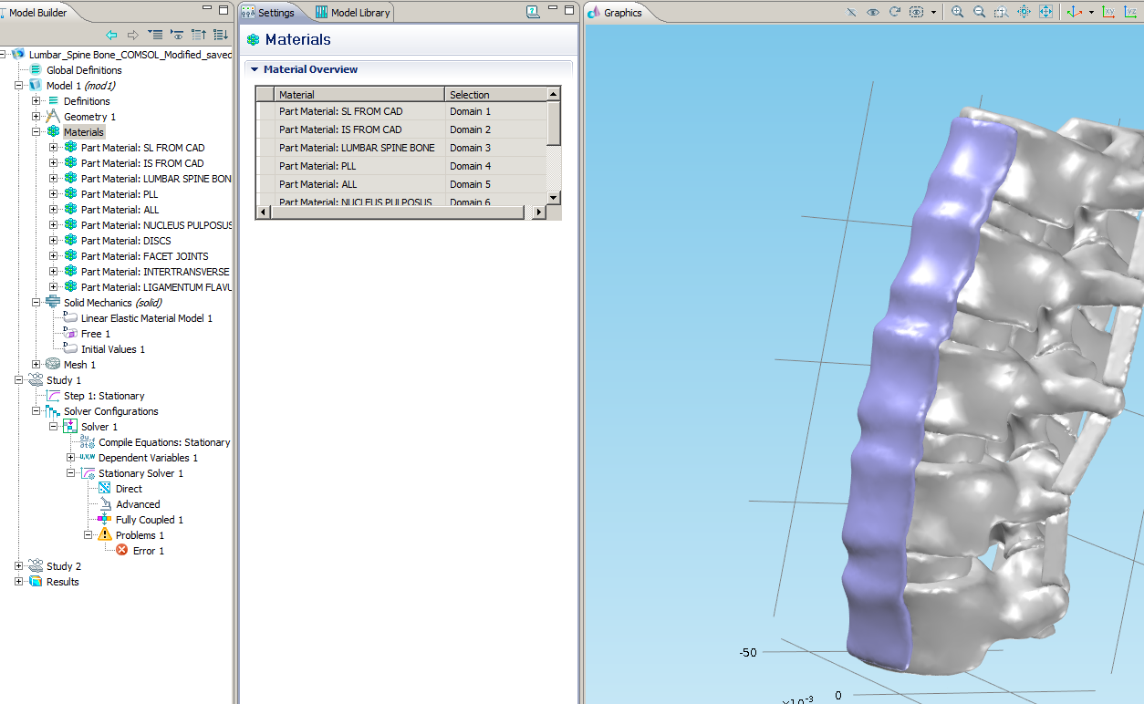

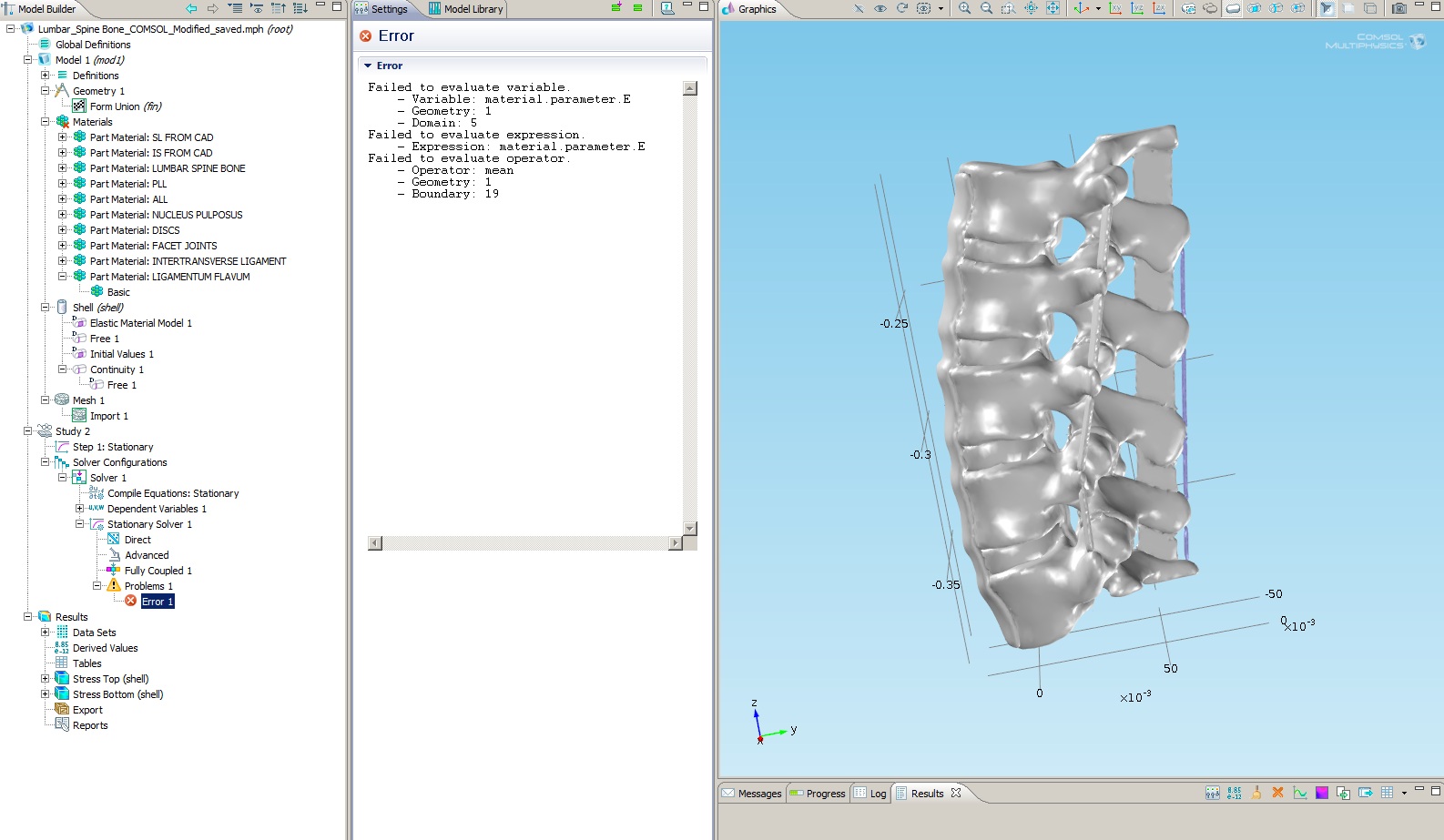

Though i change the parameters (Young's Modulus) for many number of times. I keep getting error messages like these,
Failed to evaluate variable.
- Variable: material.parameter.E
- Geometry: 1
- Domain: 5
Failed to evaluate expression.
- Expression: material.parameter.E
Failed to evaluate operator.
- Operator: mean
- Geometry: 1
- Boundary: 19
After i alter the parameters in the domain:5 and it ends up giving me an error in another domain. i'm unable to figure out where to start with the solving of this error.Can someone please help me whi this?
Thank You So Much!!

Perhaps its one of your physics settings that is set to User defined E modulus instead as "From material", or it's one of your materials that does not have E defined, (or you material is anisotropic, then you need to define the full tensor) or some domeain (5) is not linked to any material ? Or one of the numbers is not typed right, or even you are using an equation that is not fully defined, typo or undefined variable (this is not so likely, as COMSOL should have told you the variable name)
There are many combinations possible for such error
Hi Perhaps its one of your physics settings that is set to User defined E modulus instead as "From material", or it's one of your materials that does not have E defined, (or you material is anisotropic, then you need to define the full tensor) or some domeain (5) is not linked to any material ? Or one of the numbers is not typed right, or even you are using an equation that is not fully defined, typo or undefined variable (this is not so likely, as COMSOL should have told you the variable name) There are many combinations possible for such error -- Good luck Ivar
