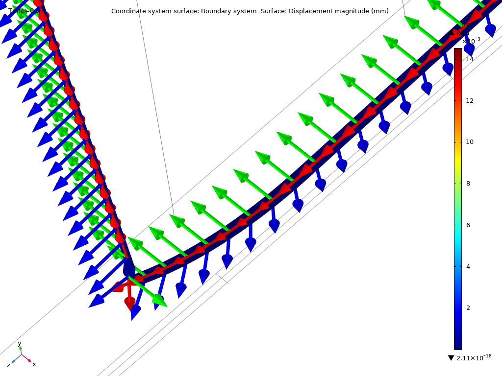

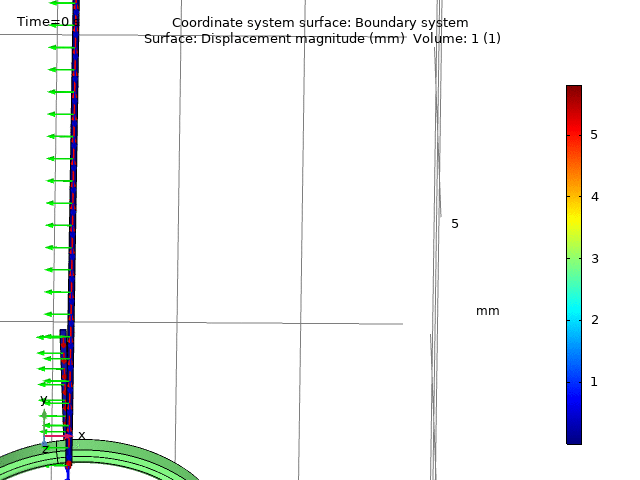

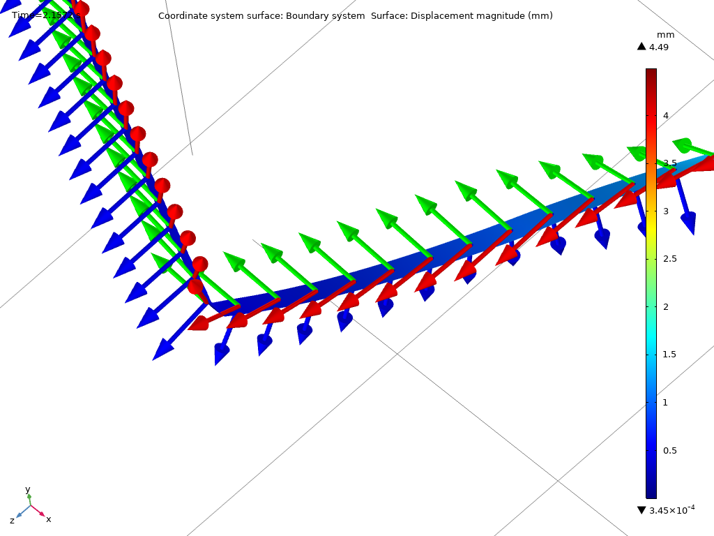

While solving the time dependent study the yarn deforms as it is bending around the counterbody. When I check the orientation of the boundary system (plot the coordinate system on the boundary of the membrane) I can see that the boundary system doesnt follow the deformation of the membrane. The boundary load is no longer oriented along the yarn by the end of the study.

(In the screenshots attached you can see how the boundary system tends to keep it's original orientation under deformation of the membrane)

With the frame setting on "deformed configuaration" the boundary system follows the deformation at first but at some point it diverges as you can see in the animated gif.
Thanks for the reply. The scale of the deformation is set to 1 in the plot (for the displacement of the membrane and the coordinate system). The frame setting is on "deformed configuration" (default setting). When I change it to 'geometry' or 'reference' the boundary system definitely keeps it original orientation and does not adjust with the deformation. I tried that after you mentioned it. With the frame setting on "deformed configuaration" the boundary system follows the deformation at first but at some point it diverges as you can see in the animated gif.

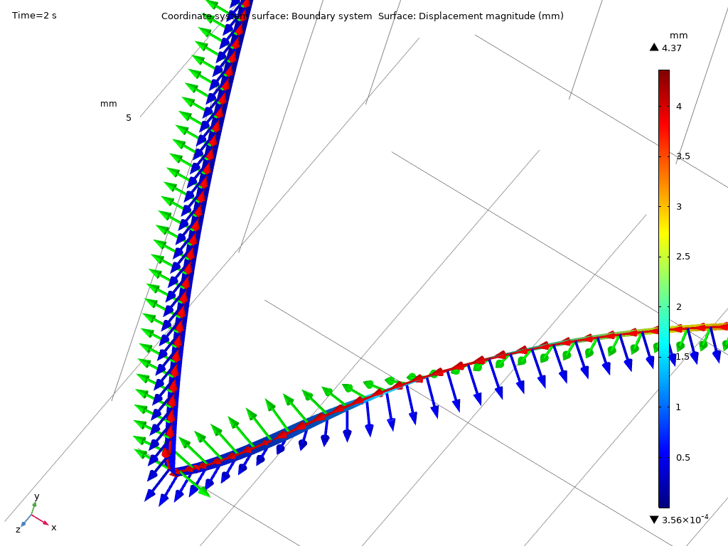

I solved it:
In the settings of the Boundary System Node there is a dropdown menu "create first tangent direction from". It is set on "global cartesian (spartial) / (x,y,z)" by default. When i set it to "material / (X,Y,Z)" the boundary system follows the deformation perfectly.

I solved it: In the settings of the Boundary System Node there is a dropdown menu "create first tangent direction from". It is set on "global cartesian (spartial) / (x,y,z)" by default. When i set it to "material / (X,Y,Z)" the boundary system follows the deformation perfectly. which makes sense when I look at the pictures in the doc: https://doc.comsol.com/5.5/doc/com.comsol.help.comsol/comsol_ref_deformedmeshes.25.05.html Thanks again for the hints!
