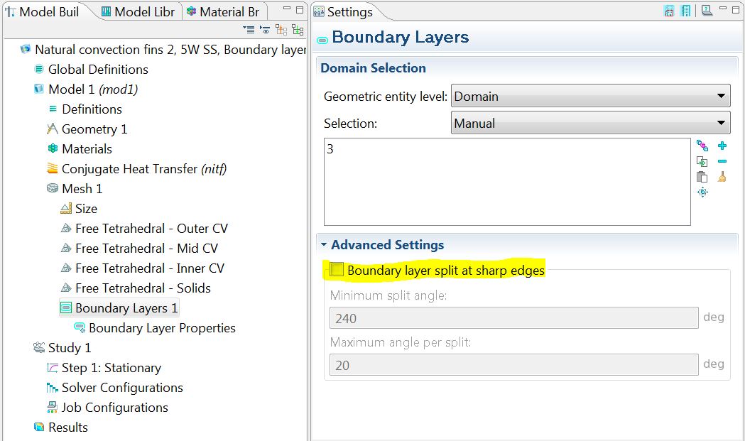

Solution:
all you need to do is:
Ver 4.2a ==> uncheck the split boundary layer check box (see pictures attached)
Ver 4.3B==> choose the trimming option from the drop menu /Engineering
works for me every time :)
