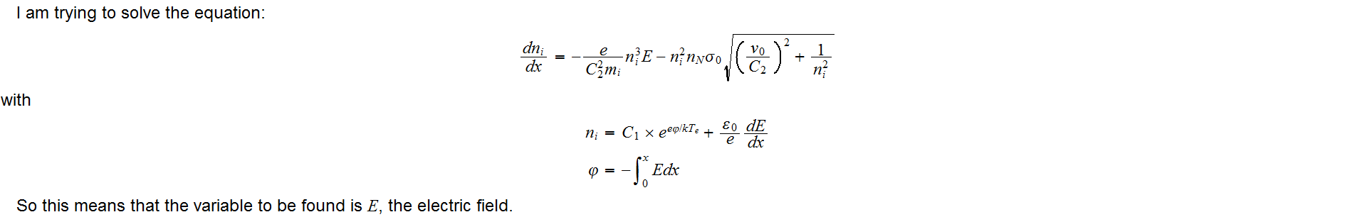

Posted: 1 decade ago 28 giu 2012, 09:10 GMT-4
In attachment I wrote what I am trying to solve.
E is the electric field and V is the potential. This must be prograamed this way because of the boundary conditons that I have. I think the problem resides in the implementation of V.
Any suggestions?
Thanks for your help
In attachment I wrote what I am trying to solve. E is the electric field and V is the potential. This must be prograamed this way because of the boundary conditons that I have. I think the problem resides in the implementation of V. Any suggestions? Thanks for your help
