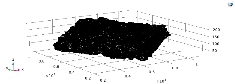

I suggest you consider the following:
1. Model something less complicated, but which still advances your understanding of the problem of interest to you.
2. Use the Comsol application mode with the simplest formulation of the physics that you are trying to study.
3. Customize the mesh in detail (don't simply use Comsol's default/automatic settings) so that you can get the most bang for the buck. Use coarser meshes in regions of slow variations, finer meshes in regions of strong gradients.
4. If there is any possible symmetry you can apply in your model? Take advantage of it.
5. 32 GB is probably not enough. Obtain a far more powerful computer with much, much more RAM (e.g., 100s of GB of RAM would be a good start).
6. Use a more memory efficient (but yes, possibly painfully slow) iterative solver, if you aren't already doing so. Experiment with solver settings.
7. Set discretization to lowest-order (e.g., linear) elements and the coarsest meshes that you can get away with, if you aren't already doing so, at least to start.
Once you have a model that actually executes without running out of memory, you can start improving its validity by (for example) using a finer mesh, modeling a larger volume, etc. Do simpler smaller models of the physics of interest first. Only after you have those working, should you attempt large, complicated, computationally-demanding models.
