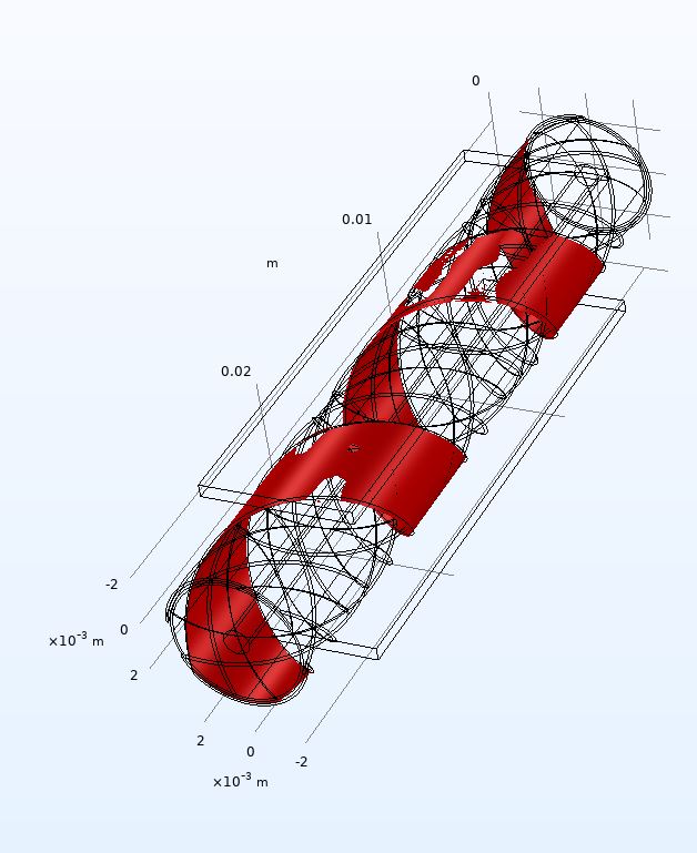

I would like to visualize the result of a simulation on a parameterized surface, but I have a problem. In particular, COMSOL does not "see" part of the surface due to the deformation.
Do you know how I can fix this?

You could perhaps make the parametric surface on the material frame (not deformed) and plot it using a Deformation subnode. See attached a simple example.
