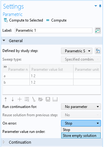

I want to perform a parametric study.
I have four variable with 4 set of values each. In all combination setting in parametric sweep it creats 256 combination of parametric set, which has to solve by COMSOL.
Now I am facing convergence error at some of the set out of 256 combination which stop the whole simulation. ( For example that in my case after runing upto 143 parametric set the simulation stop at 144th set of parameter set (convegence error). I am sure that if somehow I skip 145th set the simulation again start from 145th smoothly.
Now my question is that is there any procedure , so that I can skip some of the combination from the parametric set. ( in parametric sweep setting all combination setting).
I am highly thankful for your valuable feedbacks. Shyam

You can control that behavior using the On error control in the Parametric node, see the attached screenshot.
Henrik Sönnerlind
COMSOL
You can control that behavior using the *On error* control in the *Parametric* node, see the attached screenshot.
