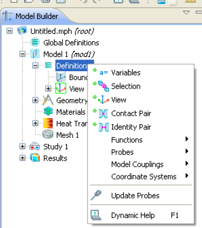

I cannot find the Infinite element domain node, which I thought was under Definitions. I'm using the Heat Transfer in Solids in the base package. If it is not available there, where could I find it?

there has been some changes in 4.3, to make all physics similar, I eelieve its under Global Definition ? I would have to check the doc too, anyhow, its worth to reread the doc regularly, specially when they change such issues, as the hypotheis might change too

Dear Mr Peterson,
I had the same problem: For using the infinite element domain
you need the corresponding Comsol module for _each_ used
physics interface (AC/DC for es, Microfluidics for chds...).
The base package has no infinite elements, though it is documented in there.
