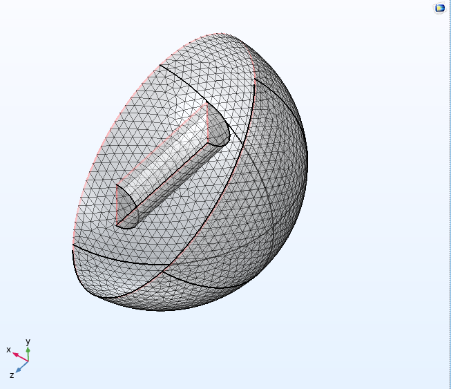

I am working on simulating an electrodynamic bearing and I need to perform mapped meshing for the copper ring and magnet, while using tetrahedral meshing for the outer air boundary. I would like to know if it is possible to achieve this in my simulation

Hi Supreeth,
Yes, it is possible. You can combine domains that use different meshing techniques (that are applicable to those domains). I have attached a screenshot from a geometry with a cylinder meshed using a mapped mesh and a surrounding sphere using a free tetrahedral mesh (using a Cut Plane feature to "look inside" the mesh.
Magnus
Hi Supreeth, Yes, it is possible. You can combine domains that use different meshing techniques (that are applicable to those domains). I have attached a screenshot from a geometry with a cylinder meshed using a mapped mesh and a surrounding sphere using a free tetrahedral mesh (using a Cut Plane feature to "look inside" the mesh. Best regards, Magnus
