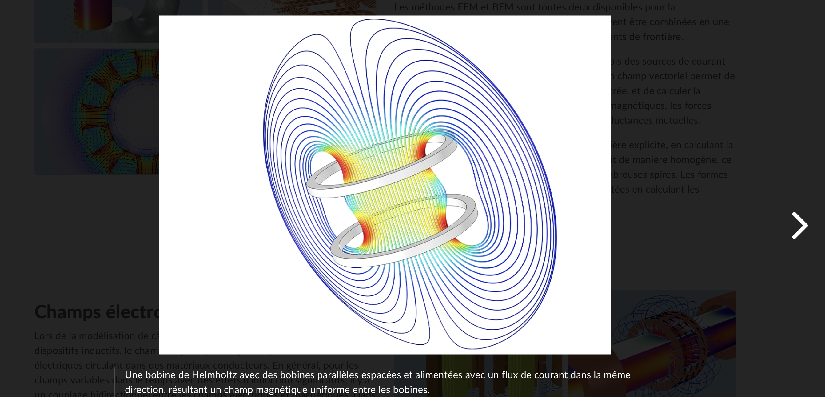

there is an example for Helmholtz coils in the application library that comes with COMSOL.

thank you very much for your answer. It's possible to optain the file with the coils already modeled and then do the desired experiments?

The coils are in the model. You only need to modify them according to your needs.

Where i can find this please ?

If you have COMSOL, go to Files->Application Libraries, and search 'Helmholtz Coil'.

That model is part of the AC/DC Module's application libraries, so you will need both COMSOL Multiphysics and that module on your license.
The model and its documentation can also be found in the Application Gallery on COMSOL's website: here is the link.
