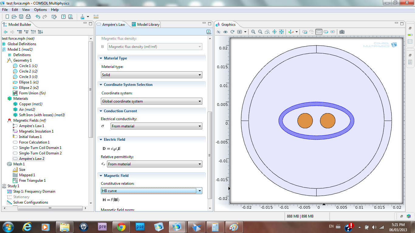

I have a simple 2D model of two coils with opposite currents. The coils are surrounded by an iron core with non-linear permeability (BH curve). I am trying to get the magnetic field distribution for 60Hz currents.
I added a new ampere's law for the iron and selected BH curve.

I have attached a picture of my model and would really appreciate your help with it.

how are the current flowing, for me in 2D its not a "coil" but a wire and your current is flowing in the Z direction out of plane. For me the coil physics is for a current doing a loop IN the plane. You should "just" define surface currents, in my view
Hi how are the current flowing, for me in 2D its not a "coil" but a wire and your current is flowing in the Z direction out of plane. For me the coil physics is for a current doing a loop IN the plane. You should "just" define surface currents, in my view -- Good luck Ivar
