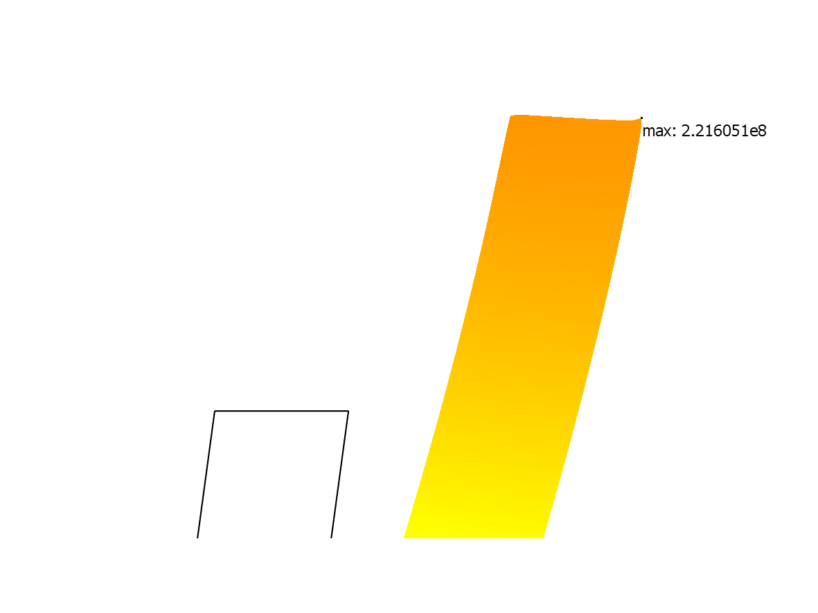

let mi join in. I did just as in example from smeug.pdf, but for 2D case, but what I get is not exactly what I want. I use ideal constraints, weak constraints are off. Any idea why the boundary of the deformed solid is not a straight line?
This straight line constraint is the only condition for this boundary.

Hello, let mi join in. I did just as in example from smeug.pdf, but for 2D case, but what I get is not exactly what I want. I use ideal constraints, weak constraints are off. Any idea why the boundary of the deformed solid is not a straight line? This straight line constraint is the only condition for this boundary. thanks in advance, aap

But are you sure that what you "want "is really reprsentative of the physics and the model you are using ?
what are your boundary conditions and your material stiffness tensor you are using ?
Have you tried to set nu=0 the Poisson coefficient to be sure you are not observing a stress-strain cross coupling effects?
And have you checked your force/pressure fields and reaction forces to be sure you have no stress concetration or BC (booundary condition) "concentrations" ?

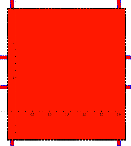

thank you for the answer. Let me quickly introduce the problem. In model.png there is a periodic unit cell. No matter what happens inside the cell, ends of these ''beams`` should remain compatible in terms of translation the unit cell. In other words the boundaries should be the same due to the periodicity (right-left, top-bottom).
My plan was to put left and bottom beams ends on the roller. For right ends there is a prescribed Rx and free Ry.
Until now we have all ends horizontal or vertical. The only boundaries to be constrained are the upper ends of the beams. That's why I wanted them to stay horizontal. But I realize this approach is not perfect.
Do you have an idea how my goal could be achieved?

Dear Ivar, thank you for the answer. Let me quickly introduce the problem. In model.png there is a periodic unit cell. No matter what happens inside the cell, ends of these ''beams`` should remain compatible in terms of translation the unit cell. In other words the boundaries should be the same due to the periodicity (right-left, top-bottom). My plan was to put left and bottom beams ends on the roller. For right ends there is a prescribed Rx and free Ry. Until now we have all ends horizontal or vertical. The only boundaries to be constrained are the upper ends of the beams. That's why I wanted them to stay horizontal. But I realize this approach is not perfect. Do you have an idea how my goal could be achieved? thanks a lot, aap

Yes probably it's the "roller" condition you want, which is implemented as the other conditions with a weak constraints, see the "Physics - Equations systems - Boundary Settings - Weak tab" and change the boundary conditions, use a name or a value such as Rx and Ry or 1 and 2 for the displacements to distinguish them from the "0", as there are already many of those "0", otherwise the formulas will not be completed ;)
If you need a combination forced displacement and roller you must set up the equation yourself. There are a few examples in the doc, we discussed one with a rigid edge in an otherwise flexible beam in another threads, its also well described in the doc

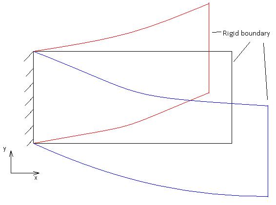

thanks for your answer. I found some papers dealing with periodic BCs in case of bending and what I need is to prescribe _equal distance between ends of deformed beams_. Comsol's periodic BCs are not applicable it this case (Repeating Unit Cell will not match its image). The question is now how can I do it? As I wrote in previous post to keep the distance between deformed ends it's enough to equate some derivative to zero. I got no clue how.

In fact I'm realising only now, what you are asking for is a "zero rotation Rz" since you allow the motion in "x" and "y" but you do not want the line to ROTATE.
This is possible on a free boundary with some tweaking of the equations. For some reason (still not 100% sure why, could be that its only of specific use in structural hence not "general enough" for the COMSOL developers, but pls do not hesitate to remindthem so this will once be implemented for the structural !!) the antisymmetric tensor representation of the deformations is not implemented, you have to write it out by hand yourself. The antisymmetric tensor is the local infinitisemal rotations.
In 2D the Rz or rotation along the Zaxis perpendicular to the X-Y plane is the value thz=0.5*(vx-uy) set this as a "Global Expression" in your model.
This is typically explained in books like: "Elasticity, Tensor, Dyadic, and Engineering approaches" by Pei Chi Chou & N.J. Pagano, Dover 1967, chap 2.5, or Theory of elasticity S.P. Timoshenk, J.N. Goodier, ch7 §83 or compare with the definition of the symmetric strain tensor
Then, once you have defined the variable thz, you need to constraint your boundary. This I have only found the "hard way" to edit the equations, by selecting the boundary(ies) (normally it's defined as free but might have an additional load) and then go into the "Physics - Equation systems - Boundary systems - Weak tab"
Edit the CONSTR line (in 2D SMPN there are 3 items for x,y,p, select the y and write "thz" instead of the value "0". This will force that thz=0 hence the angle should not change.
You still need to update the CONSTRF by replacing the second "0 by test(thz), which will adjust reaction forces to get the rotation to remain unchanged. By changing the equations in this matter you will see a small "lock" on the boundary index. This mesn that we have chnaged the eqautzions ina way COMSOL cannot "understand" and locks the boundary equations to avoid "automatic changes". You can always revert to standard COMSOL values by hitting the reset equation tab to the left of the GUI.
That's it you have blocked the rotation along Rz for the selected boundaries (edges in 2D), you can solve and study the result.
It's also applicable to 3D with the corresponding "thx" and "thy" angles. Its usefull with torque loading, but it ends up with many equations, would really have liked to have this "inside" the structural module by default :).
