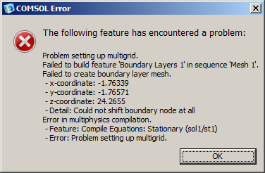

When I add a second (circular) air layer under the substrate of my sensor (Geometry 1 -> Air Layer Keramic (1/2) and (2/2)), I can still generate the mesh properly.
However, as I run the simulation (study 7-steady state) the following error appears:
Problem setting up multigrid.
Failed to build feature 'Boundary Layers 1' in sequence 'Mesh 1'.
- x-coord: -1.76
- y-coord: -1.76
- z-coord: 24.265
- Detail: Could not shif the boundary node at all
Description of the files allowing to reproduce the problem:
1) The error.png is a figure that shows the COMSOL error.
2) The 3D_laminar_8cores_1layer.mph is a COMSOL simulation where the mesh is successfully generated and that runs without problems.
3) The 3D_laminar_8cores_2layers.mph is the same file as 3D_laminar_8cores_1layer.mph despite a second air layer was added (see Description of the problem) to account for the glue between the substrate (keramic) and the housing (kovar).
Expected answer:
I hope someone can reproduce the problem and provide me hints about how to modify my mesh in order to prevent the multigrid error.
Is there anyway to solve the problem without the multigrid approach?
