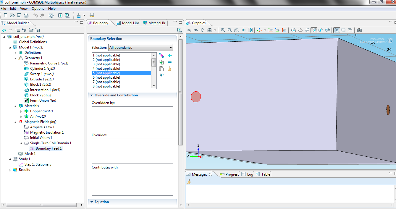

I am trying to simulate magnetic field around a inductor and I am using single turn coil domain. In the start i am trying to simulate some part of inductor not a complete circular coil. I have analysed single_coil_boundary_feed.mph but the issue i am facing is that I can't apply boundary feed and ground at the input and output of current. I see something like this when I open right click single turn to get boundary feed (in the attached image).
I also have attached my build model.
Any suggestions, i have already respected the norms such as surfaces touching the external walls of the air domain surrounding the conductor.

you have defined a node for the single domain, but you have not yet
selected domains for it. If you select domains 2 and 3, then you
can select the faces.
Regards
Jens
Hi, you have defined a node for the single domain, but you have not yet selected domains for it. If you select domains 2 and 3, then you can select the faces. Regards Jens

Thanks Jens for your help, I didn't knew that I had just this small issue
Regards
Khalid
[QUOTE] Hi, you have defined a node for the single domain, but you have not yet selected domains for it. If you select domains 2 and 3, then you can select the faces. Regards Jens [/QUOTE] Thanks Jens for your help, I didn't knew that I had just this small issue Regards Khalid
