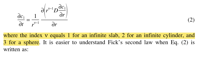

My answer to my own question, in case it is useful for anyone ;-)
You can 'change the coordinates' if you properly define your equation (by default in cartesians)
See attachment (taken from 'Extraction optimization in food engineering' By Tzia and Liadakis ,in chapter 2, 'Solid-liquid extraction' by J.M Aguilera)
My answer to my own question, in case it is useful for anyone ;-) You can 'change the coordinates' if you properly define your equation (by default in cartesians) See attachment (taken from 'Extraction optimization in food engineering' By Tzia and Liadakis ,in chapter 2, 'Solid-liquid extraction' by J.M Aguilera) Regards,
