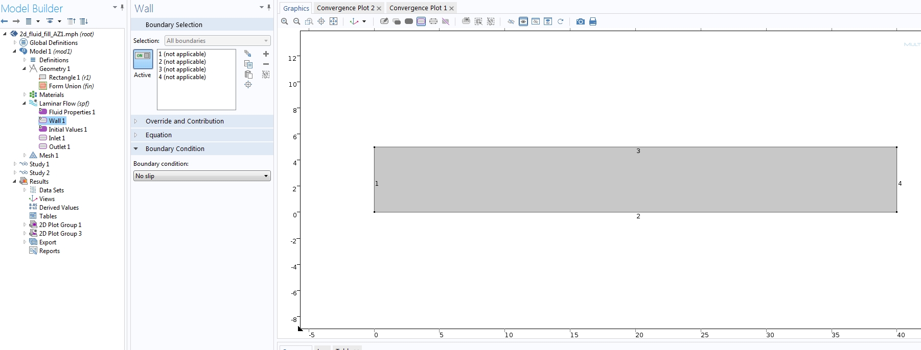

Thanks for your response. Attached is the original file that I downloaded from this forum. It was originally posted at:
www.comsol.com/community/forums/fsi/thread/18200 under "simple model of "inflating a cavity" with a fluid".
I comandeered this model as it does most of what I wanted and solves the CFD portion very quickly. There is however something wrong in the structural mechanics computation but I didn't care about that.
To reproduce the problem that I experienced, open the model. There will be an error message but just ignore. (or fix the problem)
To ensure that file is not corrupt, solve the CFD portion. It should be fine. Next, In the Model Builder go to the Geometry and delete all the geometry features. Now draw a simple rectangle. If you can, make the left the inlet, the right boundary the outlet, and the remaining two boundaries the walls.
I was not able to do that. It's almost as if COMSOL saves the boundary assignments. Dima, if you can change the boundaries freely, please tell me what you did.
Also I don't understand why I can't override the "not applicable" boundaries. I sure hope that you can help.
Thanks,
Art

Thanks for your response. Attached is the original file that I downloaded from this forum. It was originally posted at: http://www.comsol.com/community/forums/fsi/thread/18200 under "simple model of "inflating a cavity" with a fluid".
Thanks,
Art

Hi KG,
Thanks for taking the time to respond. I appreciate your perspective. BTW, did you try to open the model that I posted? It may not require the CFD module. Worth a try. :-)
There may be some quirks like you describe for the electrical models but I think that COMSOL made some big changes in how boundaries are handled in going from V3.5 to V4.XX.
I think that COMSOL has dumbed down the boundary assignment feature because folks were overriding internal boundaries and getting unrealistic results. In V3.5 it was a piece of cake to override boundaries.
When I open models created originally in V3.5, I am free to reassign boundaries as I wish; models created in V4.XX don't allow me to redraw the geometry and then reassign boundaries.
This really isn't good because prefer to use tried-and-true models rather than always creating a new one from scratch.
In looking through the forum postings, it appears that I'm not alone in having these problems.
Anyone please weigh in.
Thanks,
Art
Hi KG,
Thanks,
Art
