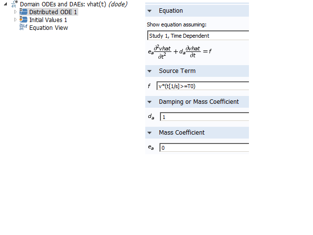

Peter,
You can use Domain ODE and DAEs (dode) interface to perform this integration, as shown in the attached image.
Sergei
Peter, You can use Domain ODE and DAEs (dode) interface to perform this integration, as shown in the attached image. Regards, Sergei
