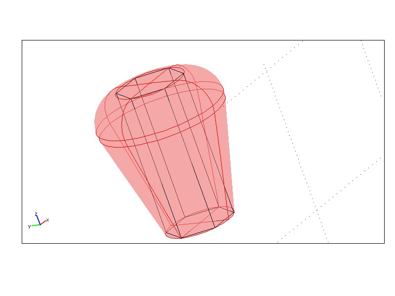

I have a question about generating identical mesh.
I built a 3D model , in which there are several prism shape subdomains (figure of this subdomain is attached).
The structure of this subdomain is a hexagonal prism and a outer shell with cylindrical symmetry.
I want to generate exactly identical mesh in these subdomains, and my idea is :
1. mesh the top boundary 2. copy mesh to each identical subdomain 3. swept mesh for each subdomain from top to bottom.
But because the top and bottom boundarys are now divided into 4 part and the swept mesh can NOT sweep from multi-source to multi-target, my idea can not work.
Could anyone give any suggestions about generate identical mesh(with copy mesh and swept mesh)?
