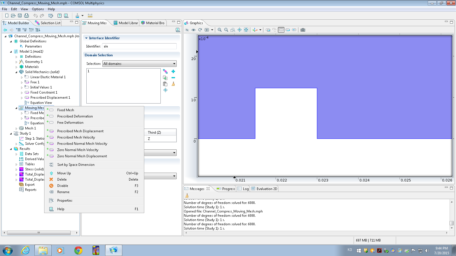

Posted: 9 years ago 20 lug 2015, 22:49 GMT-4
Hello Zhoujie,
I found ALE module thanks to your kind explanation.
I have one more question.
To apply ALE, what kind of conditions do I need to use (Please see the attached picture).
Also, do I need to modify the conditions in solid mechanics module?
I really appreciate your help.
Sincerely,
Donghee.
Hello Zhoujie, I found ALE module thanks to your kind explanation. I have one more question. To apply ALE, what kind of conditions do I need to use (Please see the attached picture). Also, do I need to modify the conditions in solid mechanics module? I really appreciate your help. Sincerely, Donghee.
