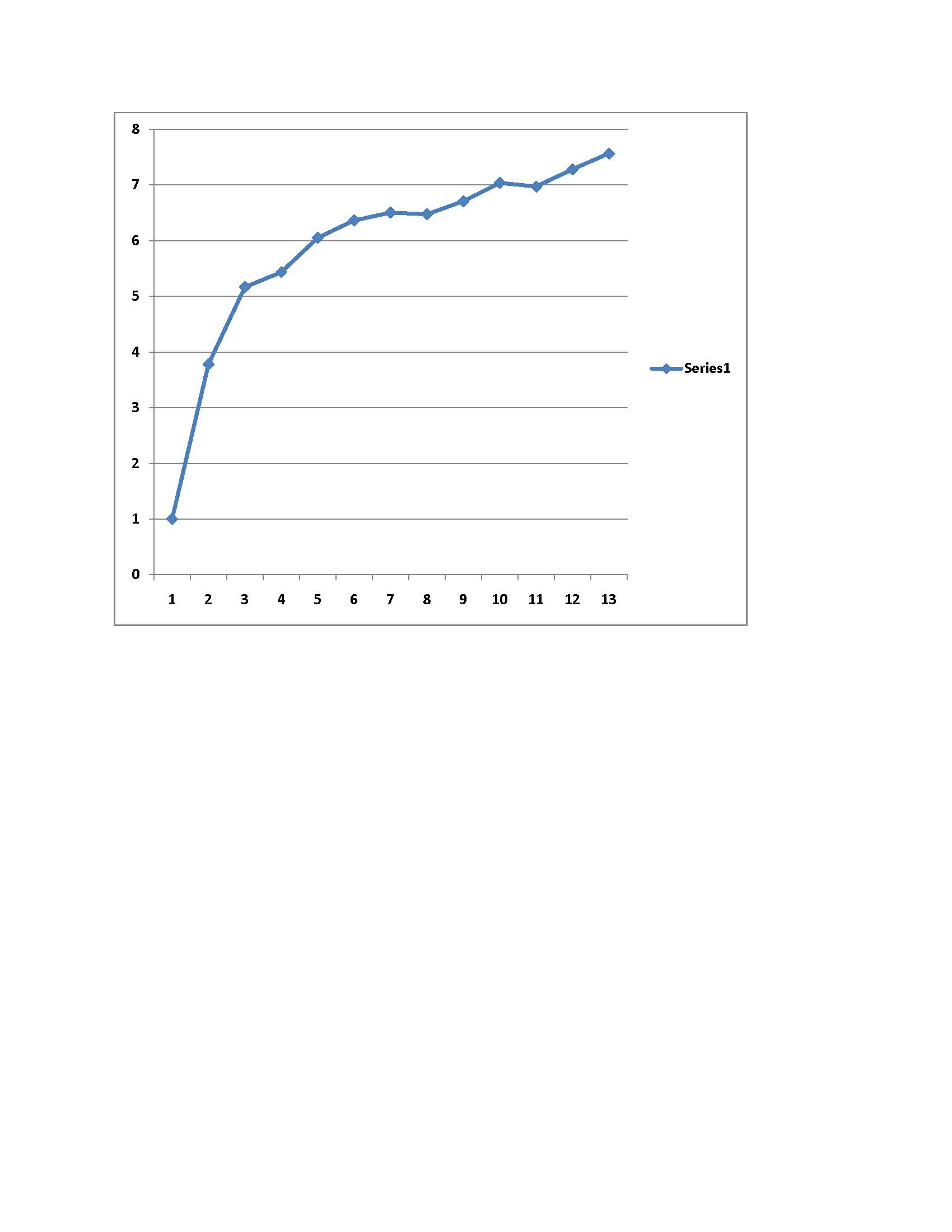

Posted:
1 decade ago
15 gen 2011, 09:42 GMT-5
This is quite an interesting topic for me now.
I have a FSI model, and did a steady-state run on my model on a 48 core ~300GB ram, with 500k DOF.
The results are crazy. It seems if I want to do 50 simulations it is the best to run 50 single cores! I have optimized the Pardiso solver to the maximum possible speedup.
Attached are my results.
aka. A real disappointment.

Andrew Prudil
Nuclear Materials
Posted:
1 decade ago
15 gen 2011, 15:23 GMT-5
Danial,
I don't think that should be too much of a surprise to anyone. Here is why:
When you write parallel code you have some sections which can be done in parallel, and other that must be done in serial. Because of this, the best parallel programs could ever hope for is to have each core running all the time. So when you run real code, and some cores have to run less time to wait for others to catch up to do the serial parts you loose that cpu time. If you run 50 instances of a single core program, each program can use the one core, and never have to wait for the other cores. It is disappointing I know, but effective CPU out put for parallel tasks scales at a power less than 1, always.

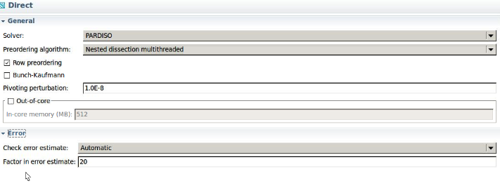

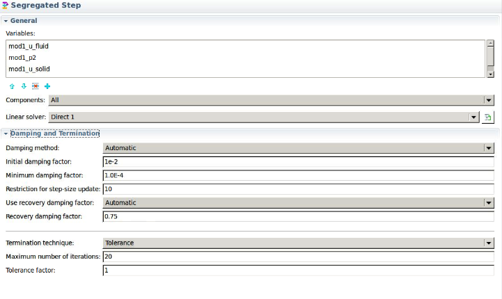

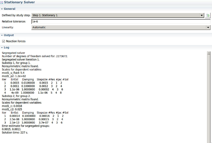

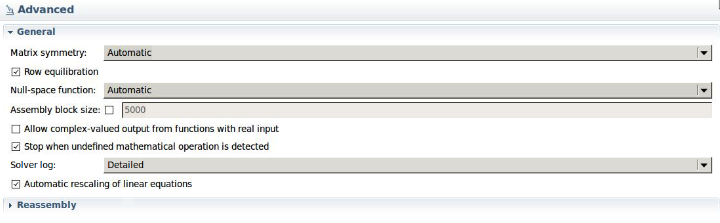

Posted:
1 decade ago
8 feb 2011, 16:24 GMT-5
First, if you want distributed parallel processing (DPP), then you must use the MUMPS direct solver. No other solver works in DPP. That is stated in the COMSOL documentation.
Second, if you have a single node, multiple cores can be used in shared-memory parallel processing with several solvers and also in other parts of the solution process such as meshing and finite-element assembly. There is essentially no constraint on the shared-memory mode of parallelism in COMSOL.
See my paper on the conference CD for some benchmarking of COMSOL v4-beta2 using DPP. I am still benchmarking with v4.1, but I can say it is at least as good as v4-beta2. Still limited to MUMPS, but it does work.
What I noticed that above 100k DOF usually Pardiso is faster than MUMS for any number of cores. So, I cannot see where PARDISO is not scaling well MUMS is scaling better.
So again, I don't think Comsol is scaling well. It is faster than single core, but for 20%-30% on many cores I don't see the benefit running many simulations. Comsol is strong on preprocessing, but weak on the solver side, contrary to well-stablished software. Please correct me if I'm wrong.
This is the subject of hot discussion between our colleagues. We run on single machine shared memory, many cores (48 core).
Edit: can we please stay on the same topic, and Giti can you please open a new thread.

As you can see from the plot I attached, I get nearly 400% speedup (compared to your 20-30% speedup) on only 8 cores and single node with np=8.
You must be doing something different.

Here is the solver configuration (steady-state) with a sample log file.
Here I am using a segregated solver to add another PDE to solve (variable c), but in my tests above I have a fully coupled solver (without the second PDE) with single F.S.I physics.

Yes, I can confirm that the row preordering was the limiting step (because not done in parallel) !
Switching it off improved dramatically the solution time, without compromizing the quality of solution (for my problem, at least).
I will try to show you later also the scaling tests.

The speed up is problem-dependent indeed, but in my case there was much gain with PARDISO when the preordering was disabled. I attach here my results for scale up experiments done on a 48-core server (2.2 GHz each CPU).
>>> Problem:
- Strongly coupled stationary laminar flow with solute mass transport. That is, the flow and mass transport equations must be solved simultaneously because the concentration affects liquid density, viscosity and (more importantly) the boundary conditions for flow (through osmotic pressure).
- Complex 3-d geometry with inlet, outlet, walls and periodic boundaries.
>>> Solution method:
- The system of equations is non-linear and with the given intial values 4 Newton iterations are needed for each solution.
The total solution time is reported in the attached file (roughly, you have to divide by 4 the time to see how much time one linear solution took)
- I tested on a mesh that leads to 3,057,962 DOFs. In these conditions PARDISO used maximum 80 to 90 Gb RAM.
- The tests are with nested dissection multithreaded preordering and without any preordering. However, I did not notice any improvement by the "multithreded" version. I use Comsol 4.1 update 2.
>>> Results:
- There is a clear improvement in speed when not using the preordering.
- All solutions returned are correct when 1, 4, 8, 16 and 32 cores are used.
However, interestingly, on 48 cores PARDISO did not correctly solve the system (neither with nor without preordering)!
- I attach results (scaling.pdf) for the total time (seconds), speed-up (time np/time 1) and parallel efficiency.
- For many cores, the preordering clearly becomes speed limiting and slows down the calculations 3-4 times!
Cristian

Thank you for posting your results. Your results are similar to what I have observed here and are what I might have expected. It appears also that even the shared-memory parallel processing will saturate the bandwidth enough to plateau after enough cores are activated. It appears that you have effectively used the hardware you have to the extent possible.
One suggestion to save some additional clock time. You might expand your solver scheme to use the segregated solver, while still using the PARDISO direct solver within each segregated step. You could first separate into two steps: 1) the u-p laminar flow (u,v,w,p) and 2) the remaining variables. This will likely take more iterations, but still save overall cpu/clock time. You may also be able to break down the 2nd step further in some cases.
The other comment is that if COMSOL users have access to a cluster, the memory requirements per node also significantly reduces in addition to the speedup of the solution. I have had at least one case where a problem would not fit on a single node, but could be run on the multi-node cluster. I expect a lot more of that in the future here.
James, using a segregated solver seemed to me possible initially. However, the problem is too "strongly" coupled (velocity u affects concentration c and c affects u, as well). I tried segregated solution and it did not work at all. It is better for weakly coupled equations (only u=>c, for example).
Anyway, thanks for the suggestion.

I have seen your results. This trend is highly probable if your problem size is comparatively small for single core itself. What happens is, if you further try to partition the problem into smaller ones, there would be lot of communication overhead among cores compared to the computation. This could hamper your overall parallel performance.
