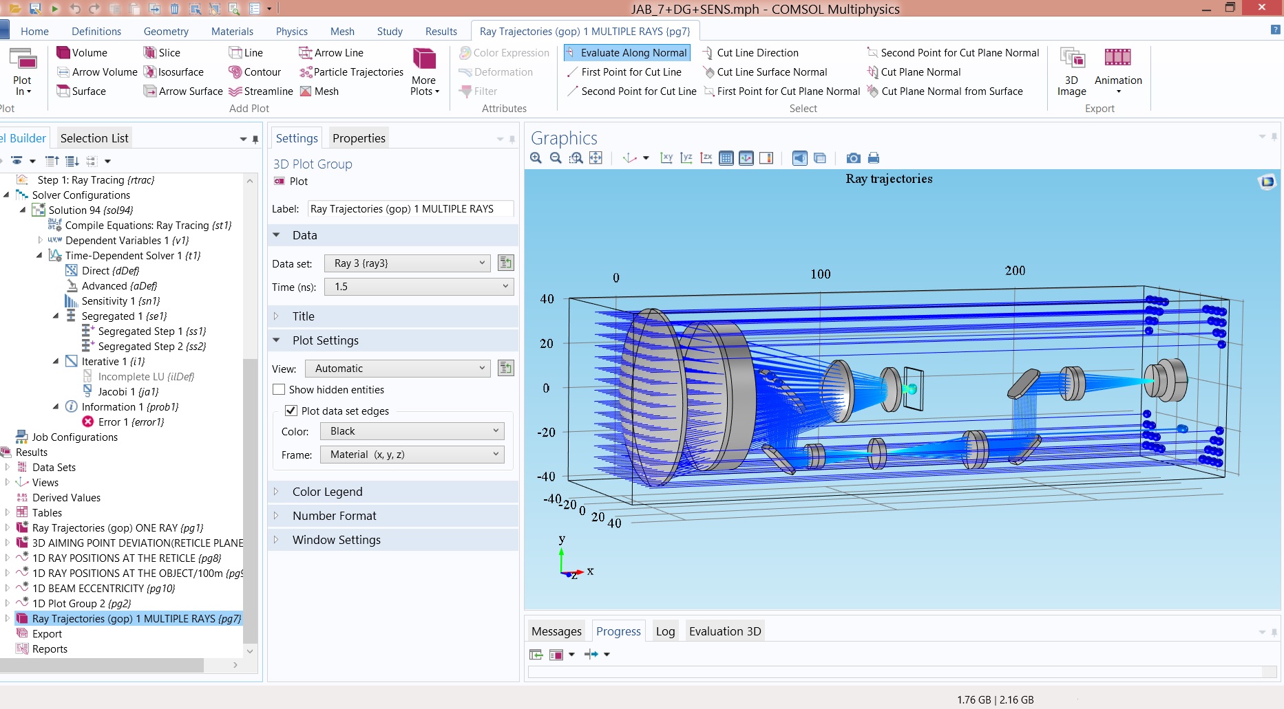

Dear All,

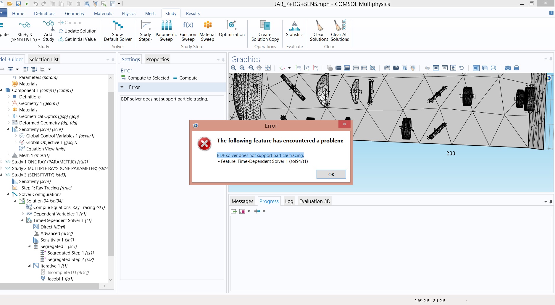

I am trying to peform a sensitivity analysis in Ray Optics module, but the following message always appears (refer to the attachment). I have an optical scheme which includes also four mirrors (refer to the attachment). By displacing and rotating the mirrors I want to know how sensitive each mirror to such movements. The criteria of the sensitivity is a displacement of a ray in a reticle plane along the coordinates `qy` and `qz` or calculated eccentiricirty `e=sqrt(qy^2+qz^2)`.
Does not it mean that COMSOL cannot perform such analysis in Ray Optics module? Why?
Is there any other variants how to perform a sensitivity analysis in Ray Optics module?
