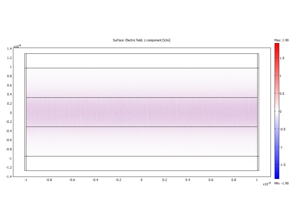

I'm attempting to simulate a simple slab waveguide (see attached). The waveguide has a core of n=1.5 surrounded by air (n=1) above and below. This design is surrounded by PML rectangles.
The boundary conditions and the size of the core are selected to be such that the electric field imposed on the three left boundaries (inside, to the right the PML, top to bottom) is a mode supported by the waveguide:
exp(-p0*y)
exp(-p0*d)*cos(h0*y)/cos(h0*d)
exp(p0*y)
The physics is based on the RF Module / photonic crystal model library in Comsol 3.5a.
I would like to know the core power input (left) and output (right). To this end, I have two questions:
1. I would like to take the core (middle subdomain), integrate the y-values and get a vector of the average power in each x value of the core. According to this vector I'd like to generate a graph of the decline of power from input to output as a function of propagation length x. Is this possible in Comsol?
2. I select the core input, and from Post Processing I choose "Power outflow, time average" (nPoav_rfwe), which seems a reasonable choice, but the results don't make sense to me (the input power -6.793381e-11 [W/m] is lower than the output -3.18875e-10 [W/m]; also, what do the signs mean? how can I simulate "time average" when the simulation is not time-dependent?). I would appreciate suggestions on how to measure the input and output power.
I'm attaching the model if anyone's interested.
Thanks in advance!

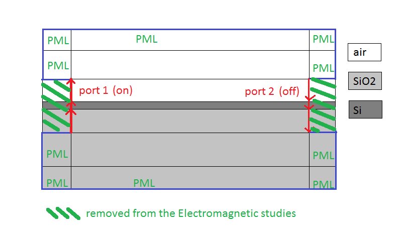

By just reading your tips, I am still a bit confused about where the PML and ports are. Would you mind to upload a simple geometry graph for me to understand better?

Answering you rquestions:
n_air = 1.00
n_SiO2 = 1.44
n_Si = 3.47
you assign them to the materials.
Then, you use the 'Boundary Mode Analysis' nodes, both linked to the specific ports, to figure out what kinds of modes the ports should excite or absorb on the 'Frequency Domain' study. In general N ports require N 'Boundary M.A.' nodes. ports are recognised by their index (1,2,3,...) and modes by their effective index of refraction. I recommend you to allow only one mode. You do it by specifying number of solutions equal to one and a relevant quess on the expected index of refraction a priori.
The result will be that you get a (transverse) mode to propagate, having some effective index, that will be n_cladding < n_eff < n_core.
If you want to account for the dispersion, you should probably parametrise the material indices somehow. (I haven't ried yet). Or as you say, try to make a time domain simulation (I also haven't tried).
You can find and attached drawing of where to assign which property. It is important that you exclude the area from behind the ports from the studies.
Good luck!
