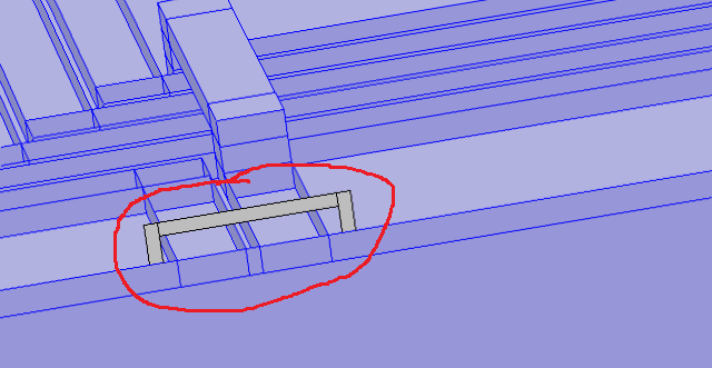

boundary selection in emw
Can any one tell me why the boundaries shown in the attached image are not getting selected in emw physics
I have also attached the .mph file.

Anurag,
Your boundaries are outside the computational domain where Maxwell’s wave equation is solved. You need to surround your structure with air domain. After that, you will be able to select port boundaries.
Anurag, Your boundaries are outside the computational domain where Maxwell’s wave equation is solved. You need to surround your structure with air domain. After that, you will be able to select port boundaries. Regards,

Thank you,
This works fine.
Thank you, This works fine.
