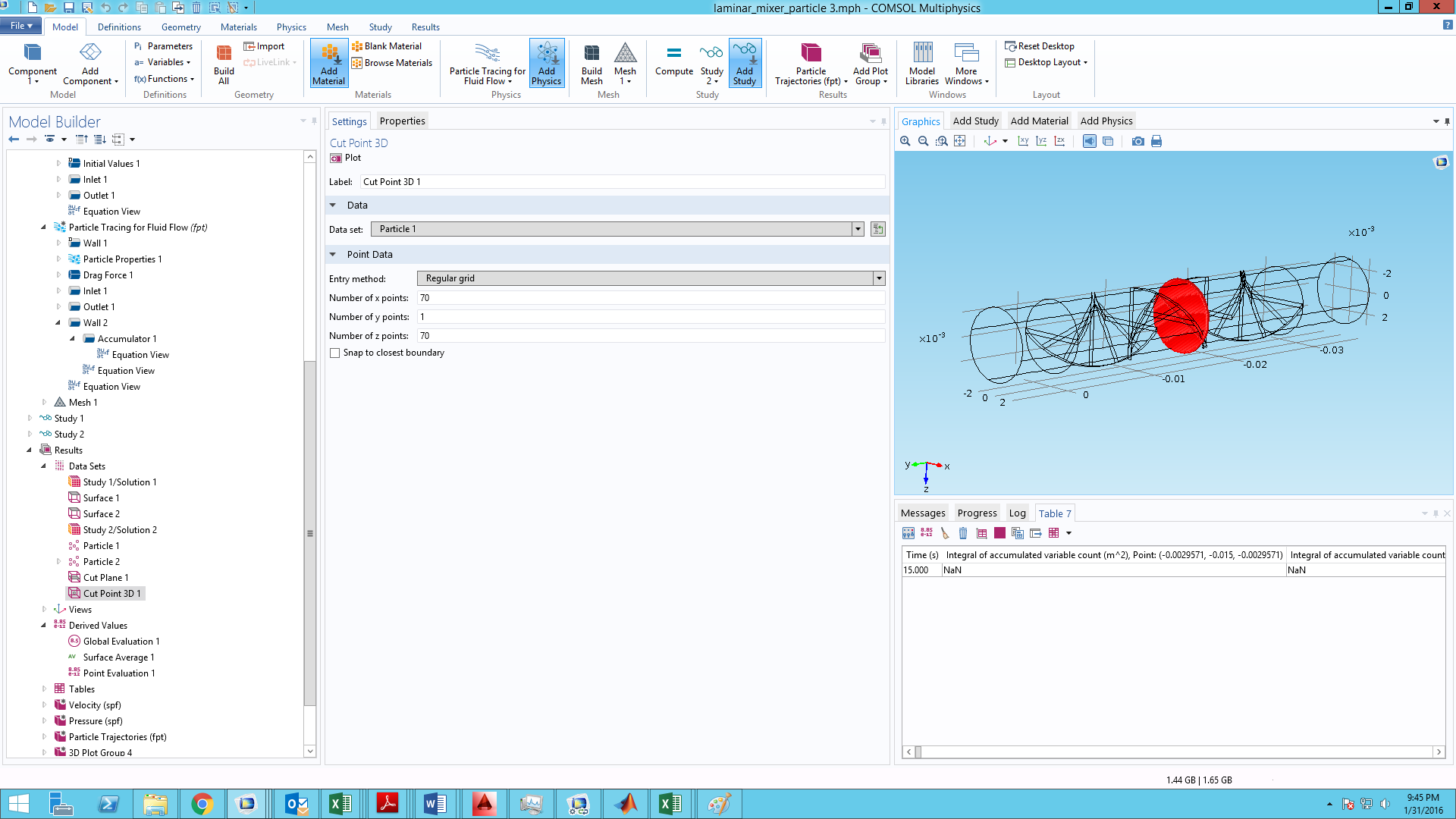

I am currently working on Laminar Static mixers on COMSOL 5.0. I have gone through the given Particle Tracer in Laminar static mixer webinar on COMSOL website. I have slightly modified the given Kenics Mixer geometry. I have introduced two surface at the start and at the end of the mixer elements. You can find it the attached screenshot. The purpose was to count the no. of particles at these surfaces. I followed the instructions given the COMSOL Blog "Different Ways to Count Particles in COMSOL Multiphysics". I selected these two surfaces separately as "wall2" , "wall3" and assigned accumulator to them. In post processing, I could be able to evaluate the 'sum of accumulated variable' for each time step for both of these surfaces. Till this point, everything is fine.
Now, my interest is to divide these surfaces in grid cells and to know for each grid cell how many particles are passing through. I do not know how to do this. Question1- is it possible to do in COMSOL?
Somehow by going through some of COMSOL discussion forums, I could find another way. I used the cut point 3D option and then used 70x70 grid. Please find the attached screenshot. I think, this option could have solved the problem if I was able to place this 'cutpoints 3d' on those two surfaces. But there is no such kind of option I guess.

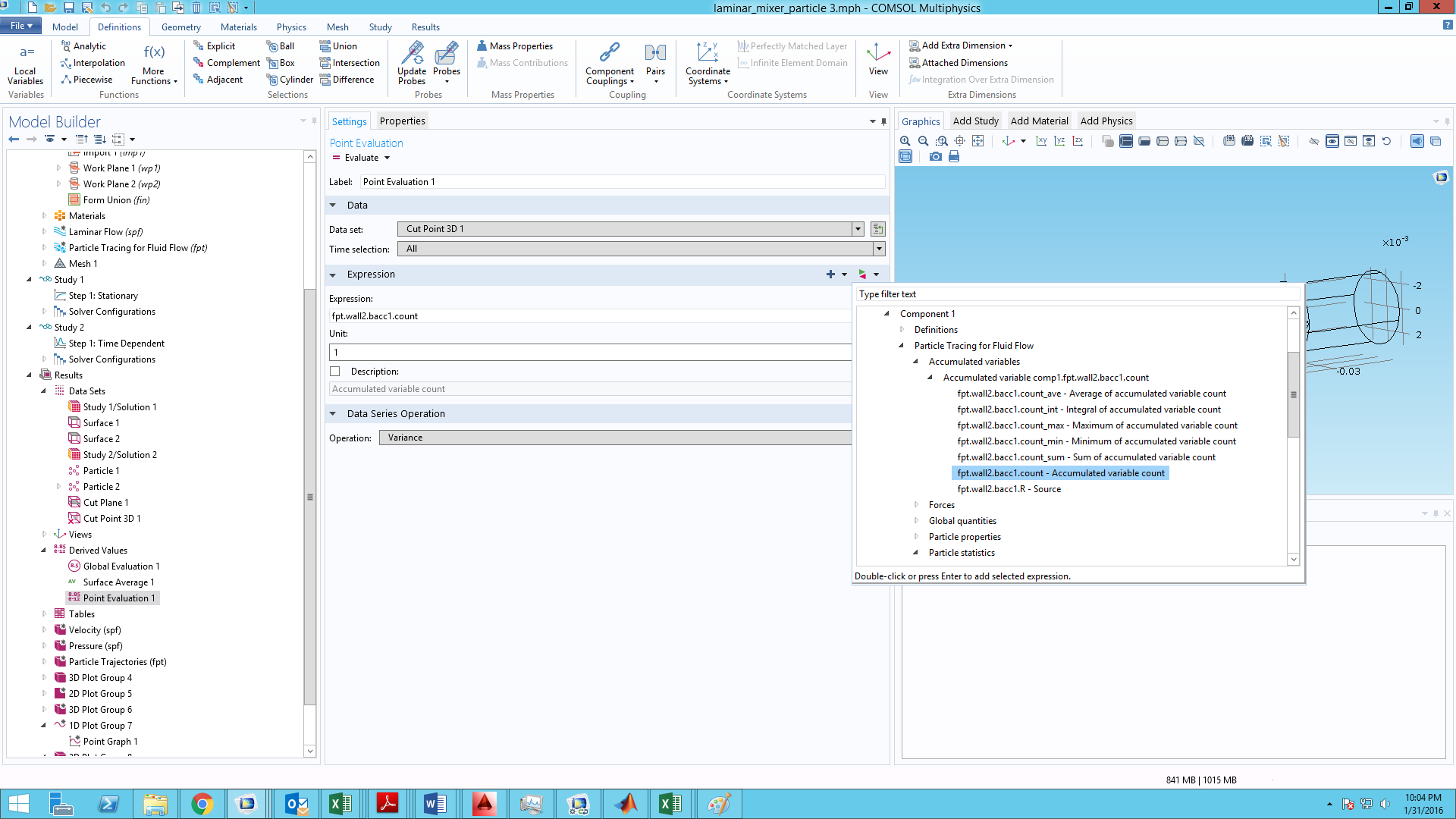

Then through 'point evaluation' option under 'derived values' I tried to evaluate the 'fpt.wall2.bacc1.count - Accumulated variable count'. But it gave me error saying 'cannot evaluate expression'.
My interest is to know how many particles are there in each individual points (cell) of 70x70 grid.

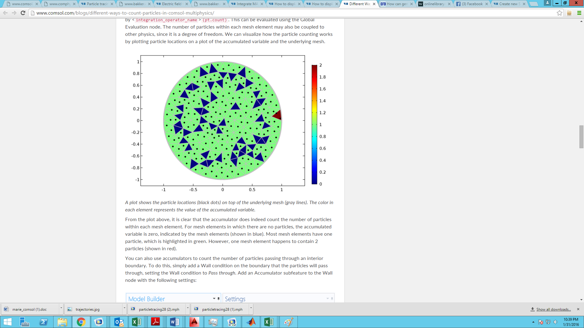

(assume it like in your particle count blog, there is one image which shows particles in each cell. In my case, I was expecting the similar one. Like at every point of 70x70 grid, some no. of particles will be there in individual cell.)
