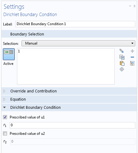

You should be able to do this by adding a Dirichlet Boundary Condition node under the Flux/Source node, and then select only the dependent variable for which you want to apply a Dirichlet boundary condition. For the other dependent variable, the Neumann boundary condition is then still active. See the attached screenshot.
Magnus Ringh, COMSOL
Hi, You should be able to do this by adding a Dirichlet Boundary Condition node under the Flux/Source node, and then select only the dependent variable for which you want to apply a Dirichlet boundary condition. For the other dependent variable, the Neumann boundary condition is then still active. See the attached screenshot. Best regards, Magnus Ringh, COMSOL
