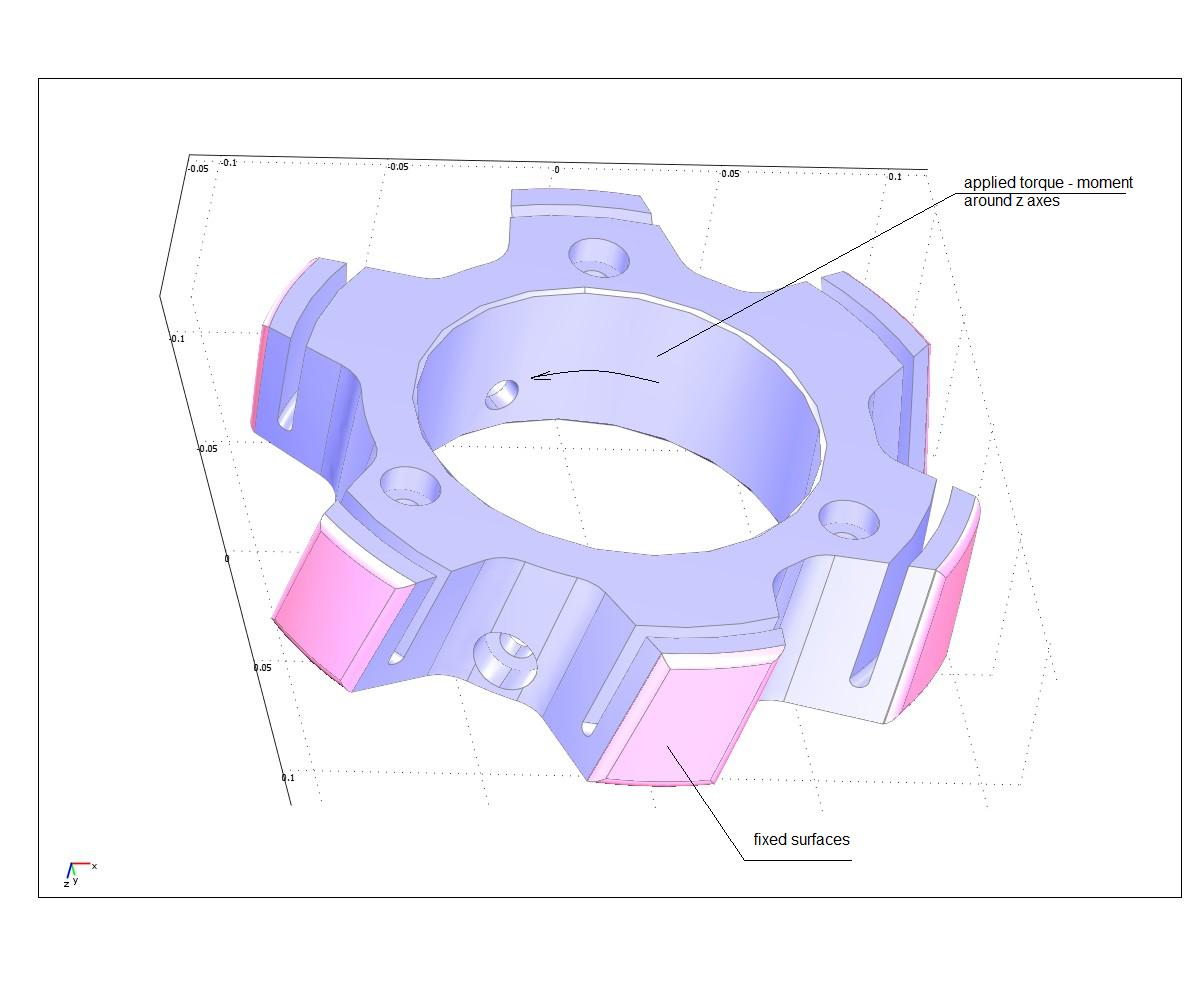

I try to model a ring blocked in the external cylinder. I want to apply the torque on internal surface and fixe external surface (see picture). But in the Multiphysics Structural , solid stress-strain analysis you can apply only load (force) or displacements(Rx, Ry). So, I've calculated a rotations (correspondant to the torque) then displacents Rx, Ry and applied int the boundary. After run the VM stress are too high and the reactive torque on the fixed surfaces is 1000 more than I considered to apply.
Do somebody used the Comsol for the torque load simulation. Please advise. Thank you very much.

You can find a very nice example in the SMEUG.pdf file EXAMPLE: Torsional moment on a cylinder. With all explanations how to apply it, I would suggest to try out the example first.
As rotations are not defined by default in 3D structural, you need to work a little with coordinate transforms, but it works very well.

Thank you for your reply. I've calculated the transformation from the angle of rotation to the coordinate change. I've tested it in Excel firstly and in the Comsol I've got the same displpacements like in Excel. But in Comsol I've got the irrealistique stresses.

If you are going to do a lot of structural as I can see on your image, you should very seriously consider the purchase of the structural module, you will quickly gain time covering the price difference
I hope the explanation below works ok without, but as I understand it there is not much specific to the structural module.

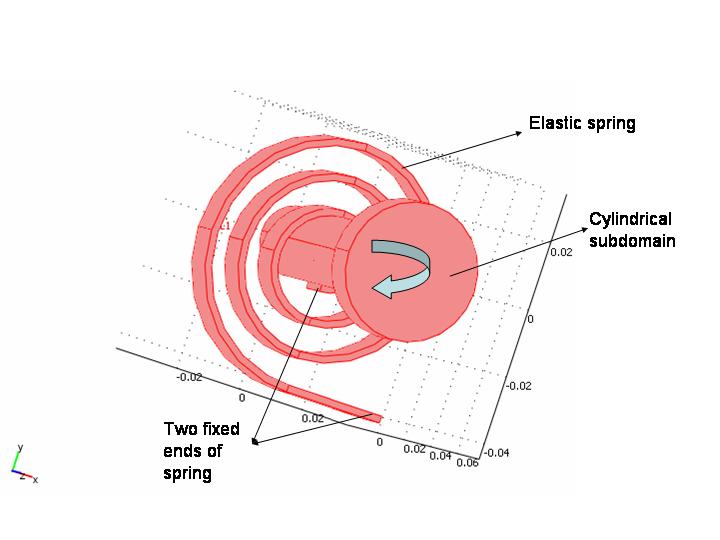

Thank u for reply.Iam not getting in correct way to do the model so
I attached my geometrical model here, that is in 3D space dimension .
The two ends of elasticspring are fixed by using holes kept on it. In middle of the spring a cylindrical subdomain is added.
Now the subdomain should rotate with the axis of rotation, and due to that there should be deformation in the spring(strain calculation due to angulardisplacement) i.e, spring winds and unwinds.
This is my problem. I didnt understand how to do this process(analysing) in Comsol.
I followed comsol multiphysics-structural mechanics-solid-stress/strain-static analysis.
I request u to send an idea how to do this process.

Posted: 2 decades ago 27 gen 2010, 17:01 GMT-5
Well basically a whatchmakers spiral and the momentum wheel.
For me it applies well to the SMEUG.PDF example (the "Structural Mechanics Module, User's Guide", see page of V3.5a page 69++ or just scan for "Torsional". For me its in .../comsol35a/doc/sme/).
I agree that the explanations are not crystal clear, and I still have a unit issue I'm not happy with (at least in V3.5a, when I follow the explanations literally) but the rotation is there when I model it, even if I cannot yet get the reaction moment to match my applied moment.
One of the items is that the "cylindrical coordinate" check used to define the new user coordinate system generates a specific rotation matrix (dump your model as a M file and check the coordinate section) that does the trick, the "geom2" workplane is only there as a placeholder to access this option for the new corrdinate transform.
If you want to force and fix the rotation axis, then I would suggest to add two points along the axis on the top/bottom surface of your shaft, and enforce a displacement Rx=0 Ry=0 Rz=0 on both points. It's slightly crude as a "point constraint" but works still quite well.

you will see that you can define the "small" angles as
thu = 0.5*(wy-vz)
thv = 0.5*(uz-wx)
thw = 0.5*(vx-uy)
It's the antisymmetric, or curl part of the general displacement formulation shown hereafter in 2D:
du = (du/dx)*dx + 1/2*(du/dy + dv/dx)*dy + 1/2*(du/dy - dv/dx)*dy
or
du = ex*dx+1/2*exy*dy-thz*dy
You can recognise the normal and shear strain and the "rigid body" rotation thz
I hope this will help you on your way

there are a few threads on the forum about torque load an torsional moments, and in the structural documentation smeug.pdf there is a good example, I needed some tries before I catched the "trick" but it works fine for me
try "torsional moment" in the search above
Hi there are a few threads on the forum about torque load an torsional moments, and in the structural documentation smeug.pdf there is a good example, I needed some tries before I catched the "trick" but it works fine for me try "torsional moment" in the search above Good luck Ivar

Dear Ivar
I was trying to reproduce the "Torsional moment on a cylinder" example in version 4
As I understood the moment is expressed in terms of stress distribution at boundary surfaces as
M=int(Taz_smsld*y-Tay_smsld*z) Where the value of M is set to 100
and tau is defined as
tau=M-100
What I dont understand is what is the need to add "tau*r" as boundary load? . If M is set to 100 then tau goes 0 !
H.
