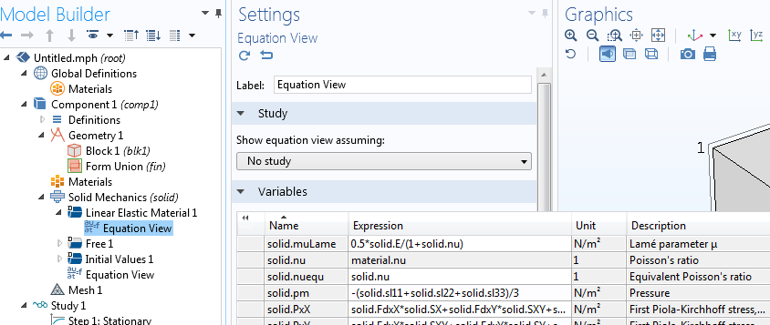

What is solid.pm exactly in Comsol Solid Mechanics?
I know it is Pressure but what is the difference between this one and stress or Piola stress? I could not find it in the manual!
2 Replies Last Post 22 mag 2016, 00:47 GMT-4
Posted: 9 years ago 20 mag 2016, 01:50 GMT-4
solid.pm is the 'pressure', that is -trace(Cauchy_stress_tensor)/3 .
If you want to see the exact definition of a variable, go into Equation View. See the attached screenshot.
Henrik
Hi, solid.pm is the 'pressure', that is -trace(Cauchy_stress_tensor)/3 . If you want to see the exact definition of a variable, go into Equation View. See the attached screenshot. Regards, Henrik
