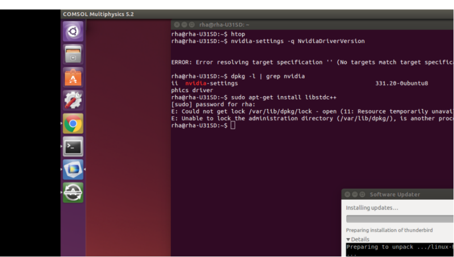

I have a problem with Comsol on my Linux laptop. Comsol seems to start and running in the background but the GUI or view doesn't open perfectly. I see only that threre is COMSOL open (see picture which I attached). When I installed comsol at the first time all work well but now i have this problem.
- Different Nvidia drivers tested and still not working
- I try to install comsol second time but it did not help either
Has anyone else come across the same problem than I have now?

Works now. Problem was that I must run the comsol.sh file inside the terminal and with "sudo" command...must be somekind of priviledge problem
